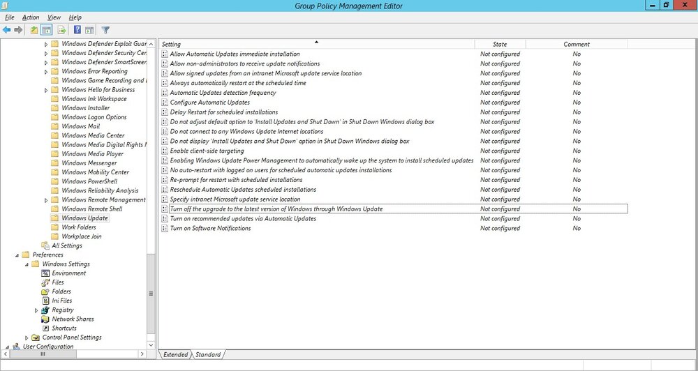

Hi Guys, I've done some 1709 Windows 10 images that I would like to stop upgrading to the latest feature update released by MS. I've looked online and found that admins have done this via the "Defer Windows Updates" found under Computer Configuration > Administrative Templates > Windows Components > Windows Update. I've updated the GPO central store to the latest Windows 10 1709 .admx and .adml files but I am unable to see this option! The server GP is running from is Windows Server 2012 R2. Please find the attached picture of what I am seeing in gpmc.msc. Anyone out there know why this is or knows how I can fix this?

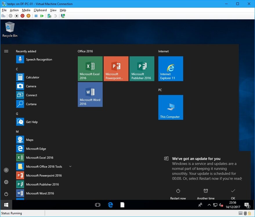

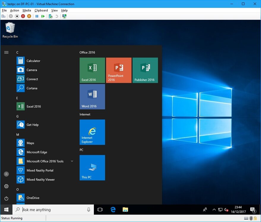

Managed to get mine working by using the below .xml string to define how big the actual start menu was and then playing around with the size of the tiles. Thanks again for your help and guidance, there were so many forums and videos out there regarding this topic but none of them made it clear. This one does!

Thank you for that info, that has broke the back of the problem. I have now managed to get redirected start menus working in Windows 10 1709. I do still have a problem relating to the Start Menu Tile Layout. I can export the .xml normal, it gets applied by GP normally but the layout isn't correct. Please see the attached pictures, the Desired picture is what im exporting and the Current is what is being applied, any idea why this might be? Thanks again for your help on this. Desired Result (what i am exporting) Current Result (what gets applied via gp) startlayoutv2.txtstartlayoutv2.txtstartlayoutv2.txt
