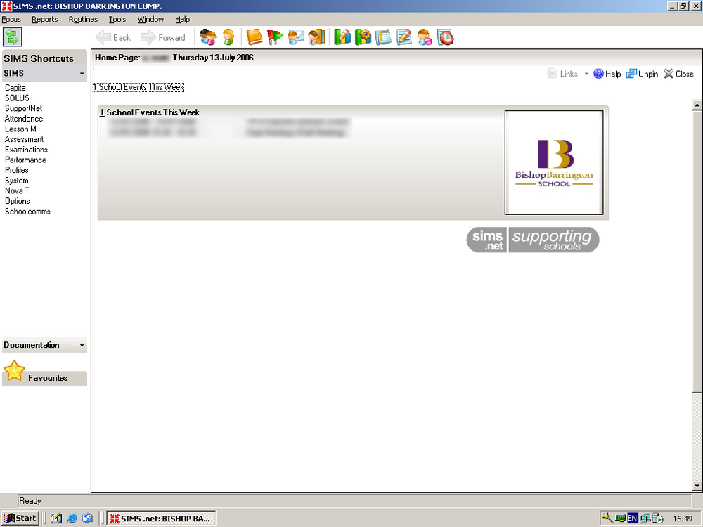

oh FFS, my lot are still whining about the previous changes to the interface.
bloody "lets make it look like XP cos that's a good interface" design gits - labels below (or instead of) icons are a _good_ thing for teachers who only use it when forced at gunpoint.
So I get teachers whining to me about how SMT have changed things again, marvellous.
It looks like Sims have got Disney in to help with their new look interface.
As my partner commented "How old do they think we are?"
Trust me even this will be 'so confusing'.
I am dreading the upgrade.
I actually posted this a while back - still dreading it - im hoping they have the common sense to at least wait until EoY has taken place before rolling this out cos everytime an update gets applied to SIMS.net SOMETHING always goes tits up...
Installed here last night with no problems at all, which was very unusual compared to last couple of updates.
Up to now no members of staff have commented on the new layout, but a couple have mentioned the dull colours.

What are you running it on? We haven't found it to be much different to the previous version.
(w2k sp4 on P3 1Ghz 256Mb are our slowest, most common machines)
No speed issues here also. Up to now I haven't seen any possitives from the change. And no comments from staff - have they even noticed its changed I wonder!
I don't think many of our staff, outside SMT, use SIMS until they're doing end of year reports, which they're supposed to have finished by now. I'd be surprised if they had noticed. All the day to day stuff is Bromcom.]
Have to look into that slow thing then, if nobody else is suffering. The server's a bit creaky, but not that bad, I thought. Only other thing, is Teacher's Desktop has gone belly up, again. :roll:

Well, we are finally done, with some outstanding issues with Nova... NM spent 2.5hrs on the phone to Capita on Wednesday morning sorting it all out.
Within 5 minutes of sending out the "you can log into SIMS again" email to all staff, the phone rang (my machine was halfway through upgrading and I'd not even seen the new front end in use):
"how do I use this new SIMS then? It looks very complicated"
*bangs head on desk* As much as I like our receptionist, she's one of these who panic and call before they try...
The only complaints I've had regarding the new interface were that the photographs had gone missing from the student window. They had their screen running 800x600 and the links bar had covered over it :/
