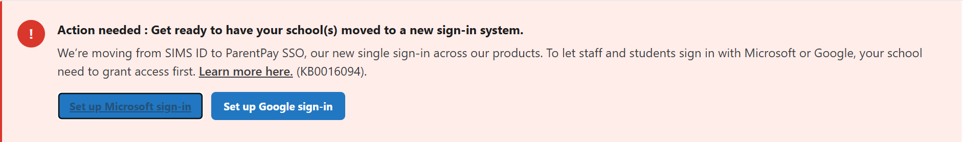

  3. One could have sso already in place! (the initial user on-boarding t is/was painful, but once set up it's wonderful and we have CA policies in place for it) I am so very much looking forward to SSO being the default, and the onboarding being straightforward. If PPG can get that in place before classcharts remove their recommendation that we fall back to the MIS for attendance, I'll have 100 new users for them immediately.
  4. Sorry, yes I assumed 365 sso.
