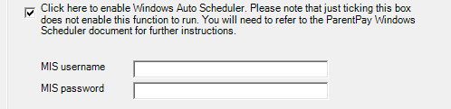

We have this but only on one server. It's a horrible bit of software that constantly locks up the machine and freezes whenever it is doing anything so I wouldn't want many people to use it.
The student sync is fully automated though so no need to run manually at all. Perhaps this needs setting up on your system? Once it is set up it runs as a Scheduled Task on the server. Ours runs once a day.
The staff sync is a manual task (not sure why), but unless you have staff starting and leaving every day there doesn't seem to be much need to give multiple users access.
I would have a look and check you have the Scheduled task configured for the student sync as this might solve the problem.

If you need the setup guide to do pupil auto uploading via scheduled task its here: https://support.parentpaygroup.com/hc/en-gb/articles/4410412727185-SIMS-Local-Setting-up-a-scheduled-task-to-upload-pupil-records-from-SIMS-into-ParentPay
I have it set up as scheduled task, at 6am and something like 5pm each day. I and one admin staff also have the MISSync on our desktop so we can manually do it if necessary plus we add staff of course (which can only be done manually)

How do you have your schedule task set up? I've tried setting it up as per their documentation, in the history on task scheduler it is running the task but nothing is uploading.
Tried emailing parent pay but to call them useless would be a compliment.

Ours is set to run the following command: "C:\Program Files (x86)\ParentPay\MISSync.exe"
With the arguments: /sims /quiet
Set to run weather or not a user is signed in, and with highest privileges.

That's exactly what their documentation says/what I've done!
Task scheduler says it's running though nothing gets uploaded. If I run "C:\Program Files (x86)\ParentPay\MISSync.exe" /sims in command prompt it just loads opens MIS Sync
