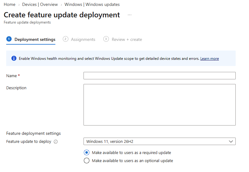

Showing as Feature Update within Intune.... No immediate rush to update, as 25H2 supported until October 2028 as previously mentioned.
