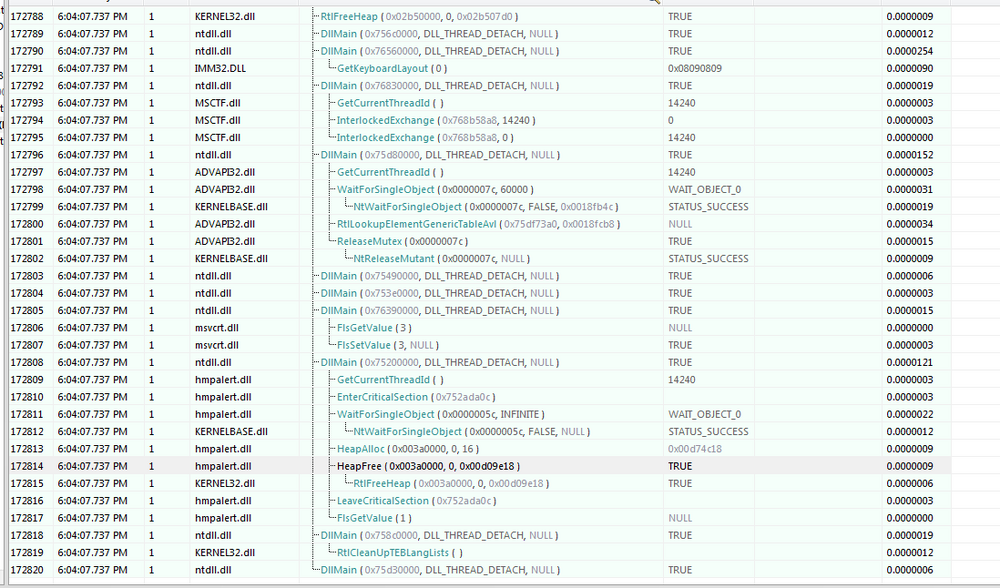

Then the I believe the final detach tries to happen:
172787 04:07.7 1 KERNEL32.dll RtlFreeHeap ( 0x02990000, 0, 0x029907d0 )
172788 04:07.7 1 KERNEL32.dll RtlFreeHeap ( 0x02b50000, 0, 0x02b507d0 )
172789 04:07.7 1 ntdll.dll DllMain ( 0x756c0000, DLL_THREAD_DETACH, NULL )
172790 04:07.7 1 ntdll.dll DllMain ( 0x76560000, DLL_THREAD_DETACH, NULL )
172791 04:07.7 1 IMM32.DLL GetKeyboardLayout ( 0 )
172792 04:07.7 1 ntdll.dll DllMain ( 0x76830000, DLL_THREAD_DETACH, NULL )
172793 04:07.7 1 MSCTF.dll GetCurrentThreadId ( )
172794 04:07.7 1 MSCTF.dll InterlockedExchange ( 0x768b58a8, 14240 )
172795 04:07.7 1 MSCTF.dll InterlockedExchange ( 0x768b58a8, 0 )
172796 04:07.7 1 ntdll.dll DllMain ( 0x75d80000, DLL_THREAD_DETACH, NULL )
172797 04:07.7 1 ADVAPI32.dll GetCurrentThreadId ( )
172798 04:07.7 1 ADVAPI32.dll WaitForSingleObject ( 0x0000007c, 60000 )
172799 04:07.7 1 KERNELBASE.dll NtWaitForSingleObject ( 0x0000007c, FALSE, 0x0018fb4c )
172800 04:07.7 1 ADVAPI32.dll RtlLookupElementGenericTableAvl ( 0x75df73a0, 0x0018fcb8 )
172801 04:07.7 1 ADVAPI32.dll ReleaseMutex ( 0x0000007c )
172802 04:07.7 1 KERNELBASE.dll NtReleaseMutant ( 0x0000007c, NULL )
172803 04:07.7 1 ntdll.dll DllMain ( 0x75490000, DLL_THREAD_DETACH, NULL )
172804 04:07.7 1 ntdll.dll DllMain ( 0x753e0000, DLL_THREAD_DETACH, NULL )
172805 04:07.7 1 ntdll.dll DllMain ( 0x76390000, DLL_THREAD_DETACH, NULL )
172806 04:07.7 1 msvcrt.dll FlsGetValue ( 3 )
172807 04:07.7 1 msvcrt.dll FlsSetValue ( 3, NULL )
172808 04:07.7 1 ntdll.dll DllMain ( 0x75200000, DLL_THREAD_DETACH, NULL )
172809 04:07.7 1 hmpalert.dll GetCurrentThreadId ( )
172810 04:07.7 1 hmpalert.dll EnterCriticalSection ( 0x752ada0c )
172811 04:07.7 1 hmpalert.dll WaitForSingleObject ( 0x0000005c, INFINITE )
172812 04:07.7 1 KERNELBASE.dll NtWaitForSingleObject ( 0x0000005c, FALSE, NULL )
172813 04:07.7 1 hmpalert.dll HeapAlloc ( 0x003a0000, 0, 16 )
172814 04:07.7 1 hmpalert.dll HeapFree ( 0x003a0000, 0, 0x00d09e18 )
172815 04:07.7 1 KERNEL32.dll RtlFreeHeap ( 0x003a0000, 0, 0x00d09e18 )
172816 04:07.7 1 hmpalert.dll LeaveCriticalSection ( 0x752ada0c )
172817 04:07.7 1 hmpalert.dll FlsGetValue ( 1 )
172818 04:07.7 1 ntdll.dll DllMain ( 0x758c0000, DLL_THREAD_DETACH, NULL )
172819 04:07.7 1 KERNEL32.dll RtlCleanUpTEBLangLists ( )
172820 04:07.7 1 ntdll.dll DllMain ( 0x75d30000, DLL_THREAD_DETACH, NULL )
And that's about the point system calls stop happening and the app just sits there. What I couldn't work out, was whether the DLL gets detached and the app hangs at that point, or whether the dll never detaches and the app sits their waiting.
I think it *might* be the former from the below:
My comment on my case yesterday was whether they could triage it as "Legacy Wise installation wizard setup programs hang with hitman pro" rather than 'capita's installer breaks'.
Equally, I would love to know if my analysis above is completely off or anywhere near the truth - but I doubt I will ever find that out

I guess this makes sense if the Solus method just copies down and overwrites existing files?
As suggested above (thank you), temporarily renaming those 2 .dll files stopped the error here.
I had the same issues when running the FMS updates.
I did not have any problem when running the Solus 3.12 update.
I did not have any problem with updating Discover.
I have opened a case with Sophos mentioning this post and asked our local SIMS support team to chase Capita.
