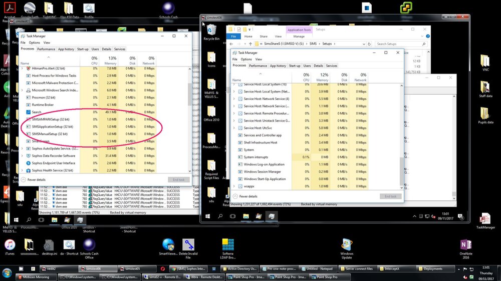

Seems they are all hanging around on the Intercept X PC!
[ATTACH=CONFIG]46126[/ATTACH]
I think that's the issue. Sophos seems to be preventing the SIMS EXE from closing when it's finished. If you were to run the installers again, you'd just end up with two of each still running in the background etc.
