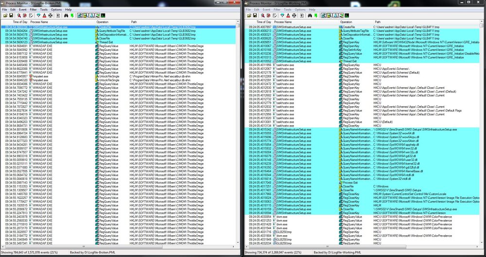

Just comparing your method on a PC with and without hitmanpro running so I can send off process monitor logs to Sophos....

Is this the point at which it all goes wrong?
[ATTACH=CONFIG]46186[/ATTACH]
That's the one. Creates those G*^&.tmp files too and they all stay open.
