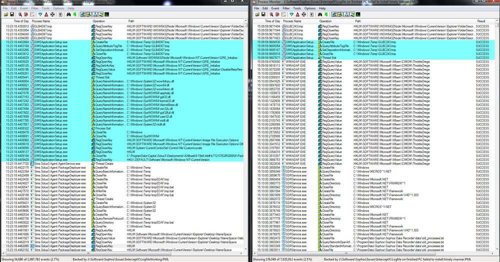

kennysarmy Posted November 8, 2017 Author Posted November 8, 2017 Also, not sure if any of you use FMS, but this fails at exactly the same point (run FMSINST.exe manually and you'll see the same as running SIMSINST.exe manually). Just at the "Prerequisites" part when it says it's going to install Adobe Reader X (even though we have Adobe Reader DC on our clients!) It just hangs there. Works fine with Intercept X disabled. Anyone seen this? I've done a normal process monitor on a working and non working PC - just comparing the outputs now - but there is a lot of data to go through!
thatley Posted November 8, 2017 Posted November 8, 2017 I've done a normal process monitor on a working and non working PC - just comparing the outputs now - but there is a lot of data to go through! Yes, Process Monitor is pretty full on!

kennysarmy Posted November 8, 2017 Author Posted November 8, 2017 SIMSApplicationSetup.exe just seems to STOP!
thatley Posted November 8, 2017 Posted November 8, 2017 Yes, that's exactly where ours stops Kenny - so frustrating! Just been told that Sophos are still looking at all the logs, so no developments yet.

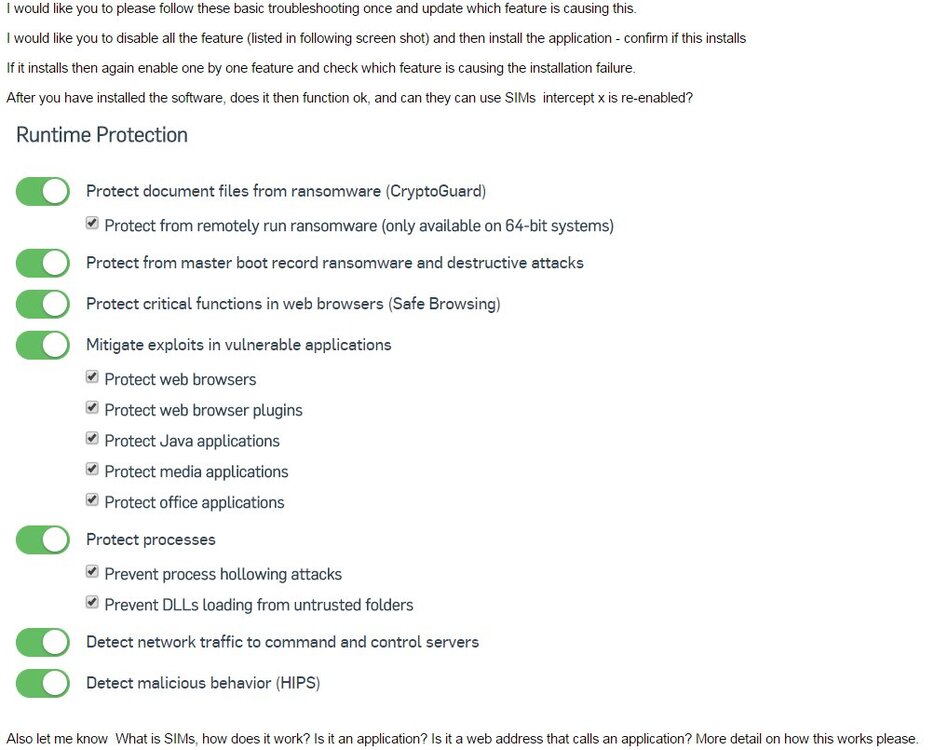

thatley Posted November 8, 2017 Posted November 8, 2017 Just tried that suggestion just for my sanity - SIMS/FMS still won't install. 1
kennysarmy Posted November 8, 2017 Author Posted November 8, 2017 Surprise surprise that did not work!
