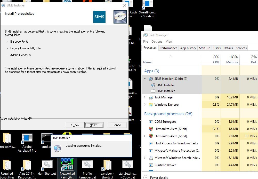

So I've copied our S:\SIMS\SETUPS folder to a workstation in the office...on it's D:\ drive.
On a PC with Intercept X installed I've mapped an S:\ drive to the above d$ share so on the test PC it has a S:\sims\setups folder.
On running SIMSINST.exe it seems to lock up.
I'm now setting up another test PC without Intercept X to see if it gets further.
If it does - then SOPHOS will have a copy of my SETUPS folder and WILL be able to recreate the issue on their test rigs!

OK - so that worked!
On the Intercept X PC it is stuck here:
Wonder if anyone else can confirm my findings?
In summary - copy the SIMS\SETUPS folder to another workstation or server.
Map the S:\ drive back in to the new location.
Test on a PC with and without intercept X
Cheers

If you look back to my earlier posts - this is what I've confirmed from the beginning. We get exactly what you're seeing.
