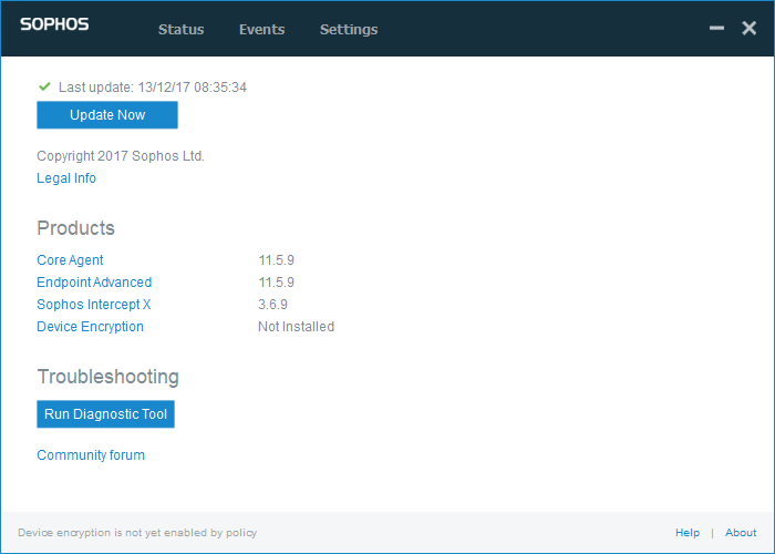

Is there a download link/path to this update? Hit update on a client and restarted. Still same issue with SIMS so guess not updating.
What is the very latest s/w version when you look at 'About'? This client is....
[ATTACH=CONFIG]46717[/ATTACH]
Thats old betas?

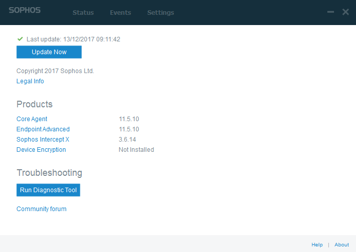

[ATTACH=CONFIG]46719[/ATTACH]
This is the version with updated InterceptX
