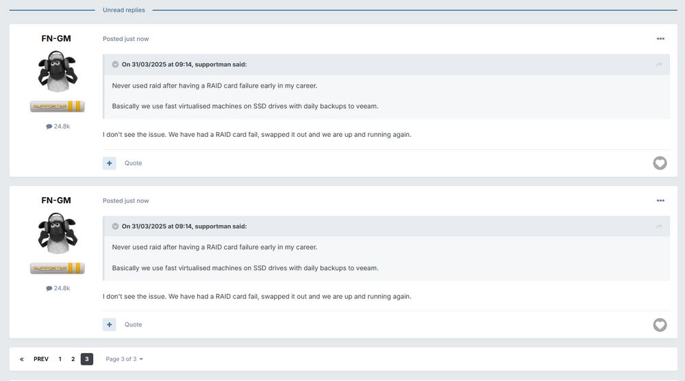

2 hours ago, supportman said:
Never used raid after having a RAID card failure early in my career.
So..out of interest if you had a server fail would you never buy another server again and install everthing on the PCs instead?
If your car broke down would you never buy another car?
Just wondering as raid card faliure is pretty darn rare - never had one myself in 24 years of doing this.
