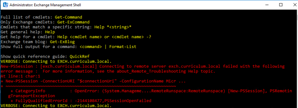

My checklist for this:
netsh winhttp show proxy
The bypass list is critical!
No web access, with 503 errors? Make sure that the current email cert is bound to the Default and site in IIS. The Microsoft Exchange default cert can be bound to the Exchange Back End.
just a note on this sometimes exchange runs as the system user but when you do netsh winhttp show proxy, it runs as Administrator not System and shows no proxy. I had this and the cert was just erroring with can't check revocation. There was a special command I could run to open CMD as System then netsh winhttp show proxy showed an ancient proxy we used to use, no idea how it got there.
