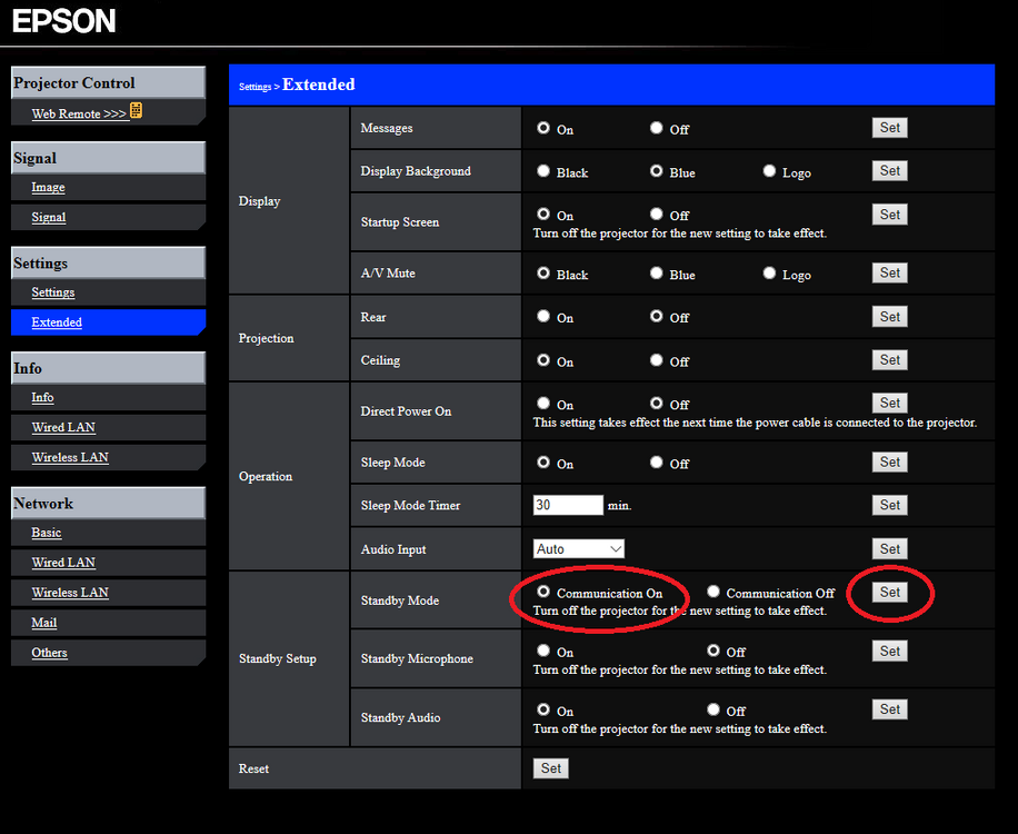

We use the EPSON Web Remote. We found that the physical remotes kept going 'walkies' too.
We put a shortcut to the remote in the root of the staff shared drive. It's configured to only connect to the projector that is in the room that that the teacher is logged into. This is done using a xampp database.
To set this up, you have to have a xampp server with a database that corelates the room computer name and the room projector name. The projectors need to have static/reserved IPs and a set name. Don't forget to turn the Standby Mode to 'Communication On'. This allows the teacher to turn the projector On from the web remote.
Here's the code for the xampp index.htm file
$hostname = gethostbyaddr($_SERVER['REMOTE_ADDR']);
$servername = "[sERVER NAME]";
$username = "[uSERNAME]";
$password = "";
$dbname = "[DATABASE NAME]";
// Create connection
$conn = new mysqli($servername, $username, $password, $dbname);
// Check connection
if ($conn->connect_error) {
   die("Connection failed");
$sql = "SELECT client_host, projector_host from mapping where client_host = '$hostname'";
$result = $conn->query($sql);
if ($result->num_rows > 0) {
   while($row = $result->fetch_assoc()) {
$projector_host = $row['projector_host'];
$url = "http://EPSONWEB:admin@$projector_host/webremote/index.html";
echo "
exit();
} else {
die("You are not allowed to access this page from this location.");
$conn->close();
Edited by TriggerHappyUK
