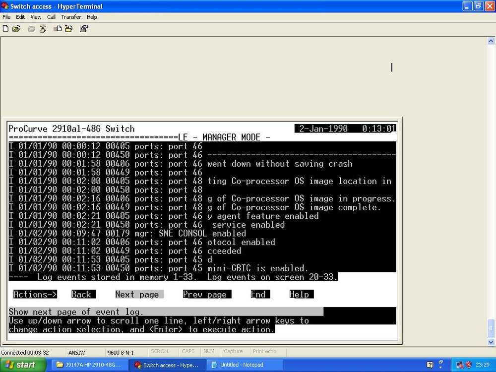

  15. Thanks for the replies, we'll have to update the firmware then but shouldn't be a problem. We generally only buy new items so i'll have to decline your offer but thank you for the offer
  16. Hi all We are looking at putting a new run in from our main switch (HP Procurve 4108gl) to a new HP 2510-24. I would just like to check to see if everything I have picked out is compatible. 2510-24 Switch http://shop.mcidiventi.co.uk/HP-J9019B-ProCurve-Switch-2510-24.html mini-GBIC module for HP 4108gl http://shop.mcidiventi.co.uk/HP-J4893A-HP-ProCurve-gl-Mini-GBIC-Module.html mini-GBIC transceivers for both switches http://shop.mcidiventi.co.uk/HP-J4858C-ProCurve-Gigabit-SX-LC-Mini-GBIC.html
  17. Sorry for the double post However we were just looking for clarification that we have the right cables. Out of the HP Procurve 4108gl it is a SC connector - OM3 cable - LC connector - Fiber patch panel - 0M3 Fiber run - Fiber patch panel - LC connector - 0M3 Cable - LC connector into the SX/LC mini-GBIC transceiver Thanks Again
  18. Hi we are going to try and update the firmware on the switch, however we just found the information stating the cable is an LC-SC Fiber cable. It appears to fit but is this the right cable? The logs do show that the mini-GBIC is detected. Thanks Nathan
  19. Thanks for the replies. We have just tried plugging the module into another switch and it worked when we swapped it with the existing module. It is a genuine HP module. Thanks
  20. Hi All We have recently purchased a HP Procurve 2910al Switch. We have tried to install a Procurve J4858C mini-GBIC into the switch. However the switch isnt recognizing the mini-GBIC. So we need to change a setting on the switch itself. The main switch our fiber is coming from is a HP Procurve 4108GL. Any help will be very much appreciated Nathan
