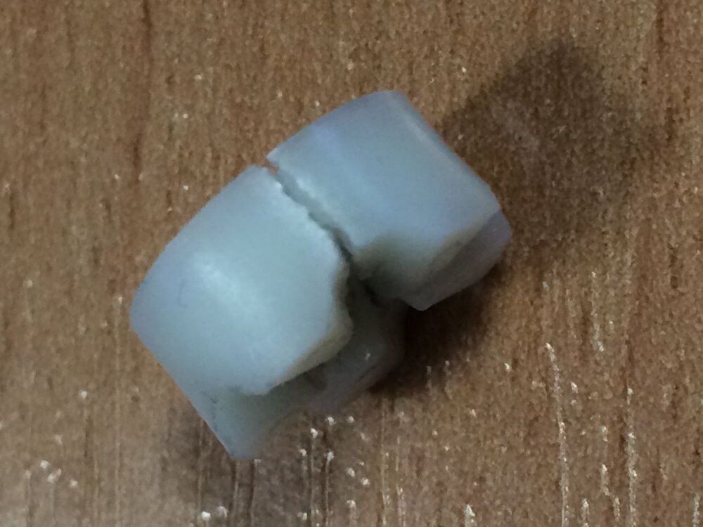

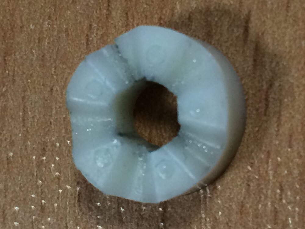

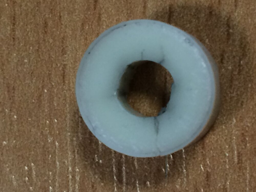

jameslo30 Posted September 14, 2015 Posted September 14, 2015 We had the same problem on our CP-A100. It did turn out to be the motor gears (the last in the chain holding the lid). Here are some pics of the broken part; I have ordered another motor from : Xtra Parts I have yet to install it, but will update here when done!

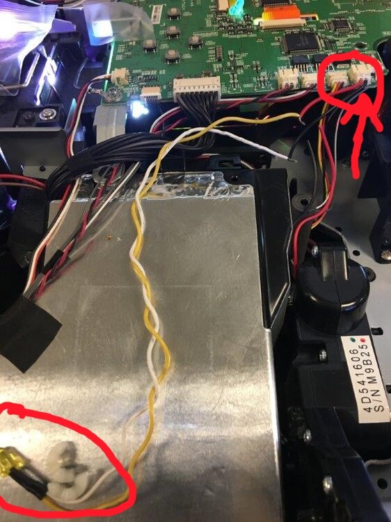

rpaulson Posted December 23, 2016 Posted December 23, 2016 Fixed mine this way, Removed broken gear. You now need to open the mirror manually. (no big deal) Wired a LED bulb to the Motor connector in circuit board. see image. rpaulson @ ezworks dot net Enjoy!
eddiebutcher Posted January 13, 2017 Posted January 13, 2017 rpaulson, What are the specs on your LED? I measured 12V coming from the board. Would a resistor do the same thing? Fixed mine this way, Removed broken gear. You now need to open the mirror manually. (no big deal) Wired a LED bulb to the Motor connector in circuit board. see image. rpaulson @ ezworks dot net [ATTACH=CONFIG]40425[/ATTACH] Enjoy!
