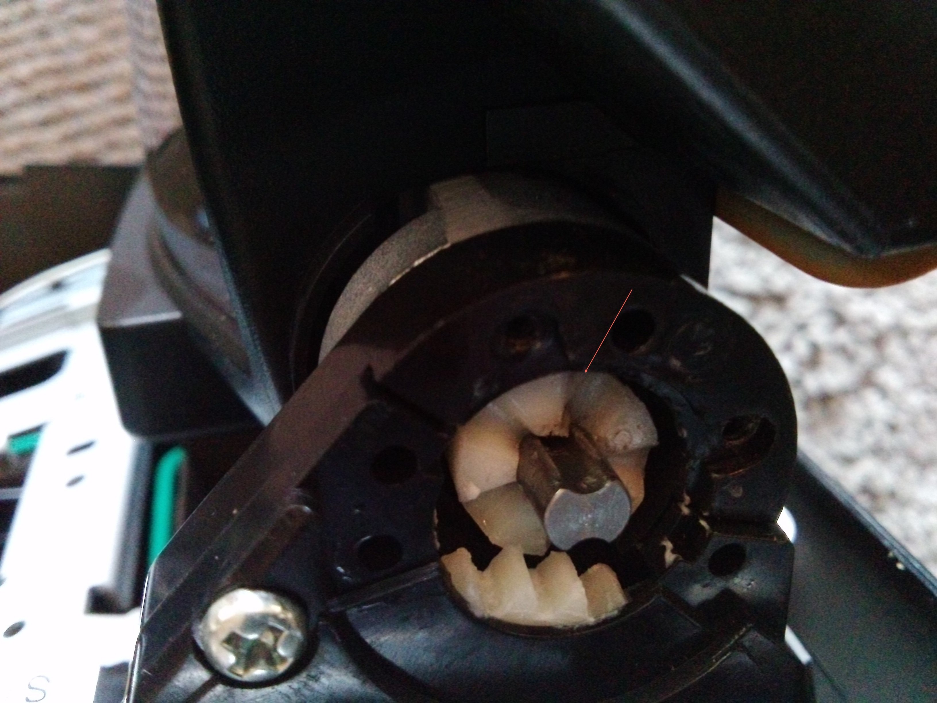

billvine Posted June 11, 2013 Posted June 11, 2013 Hey everyone! I've recently bought an ED-A111 with the same problem. I've opened it up and found the exact same thing - the cog is cracked. I've emailed Hitachi with the slim hope that they'll be able to provide a replacement. Ben - I'd be happy to send you the broken cog but at the moment I can't work out how to get the thing off!
plexer Posted June 11, 2013 Posted June 11, 2013 Which cog has broken I have some 3d printed ones of the 35 tooth one I think it is. If not if you can get it off that'd be cool. Ben
billvine Posted June 11, 2013 Posted June 11, 2013 It's this little 5 tooth one. I've stuck a red arrow pointing at the location of the crack. Just about visible on the pic!
plexer Posted June 11, 2013 Posted June 11, 2013 Ok cool if you can work out how to get it off I'll see what I can do. Ben
billvine Posted June 11, 2013 Posted June 11, 2013 Great - thanks! I'm still trying to figure it out without breaking the thing...

billvine Posted June 17, 2013 Posted June 17, 2013 Hi Skyper - have you disassembled one of these projectors to get to the broken cogs? Am I right in thinking that I need to dismantle most of the unit before I can get to the mirror motor assembly to remove it and the cogs? Thanks!
Skyper Posted June 22, 2013 Posted June 22, 2013 Depends on which cog is broken, most likely its the small one in the mirrors cylinder, if so you only need to dismantle the bottom screws to remove the top shield and then you can already remove the cylinder shield to get to the cog. If however it's one of the cogs in the cog series, you have to remove about 50 screws... I did both without breaking the thing, just take your time

billvine Posted June 27, 2013 Posted June 27, 2013 Turns out 3 cogs were broken so I did have to pretty much take the whole thing to bits! Depends on which cog is broken, most likely its the small one in the mirrors cylinder, if so you only need to dismantle the bottom screws to remove the top shield and then you can already remove the cylinder shield to get to the cog. If however it's one of the cogs in the cog series, you have to remove about 50 screws... I did both without breaking the thing, just take your time
