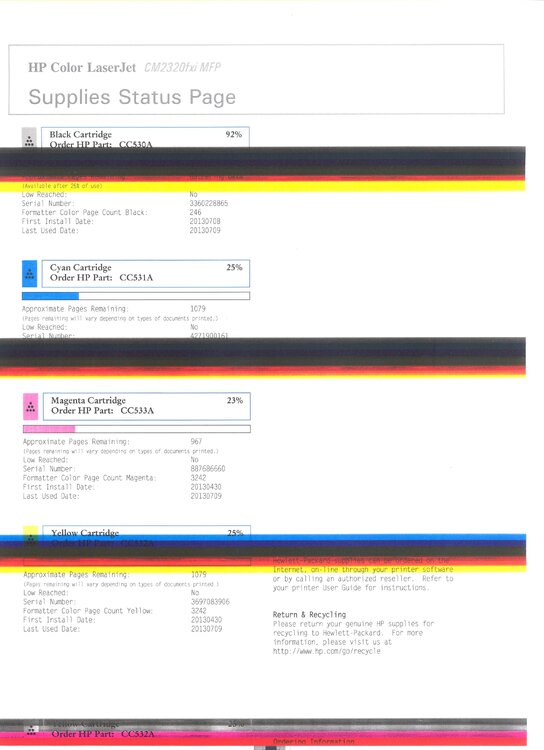

  8. thanks for the response. there is one and it has been run, the diagnostics service and usage pages all came out without the banding, it was a little faint which could point towards faulty sensors again not releasing the right amount of toner. the above then occurs intermittently on printouts, although i am informed it is happening more and more often. there had been previous issues with the printer producing a blue line down the edge of pages, this was down to a groove being worn into the drum after approx 80% of its capacity was spent. this doesn't seem to happen since switching from genuine toners. the reverse of the page in the image has very faint and much more close packed banding.
  9. one of our schools had an engineer in from their local toner supplier and he informed them that the attached was result of the printer (there are two printers doing this in school) needing new assembly belt (transfer kit?). just looking for a second opinion, quote to replace part was 228 and they offered a hp printer as a replacement for 300 after cash back which seems reasonable, with free 3 year warranty if their toners are used, which again seems reasonable. the printer the image is from is only 3 years old and has done 60k pages is the assembly belt expected expire in that length of time? any feedback appreciated.

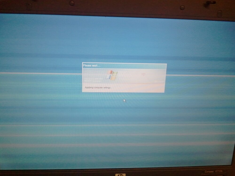

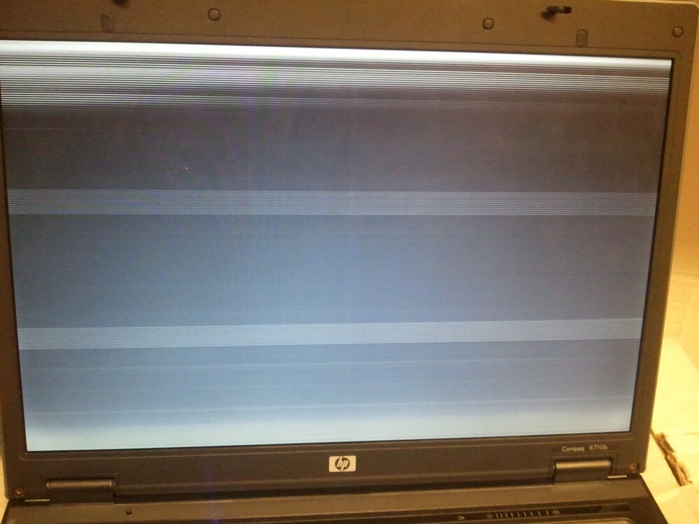

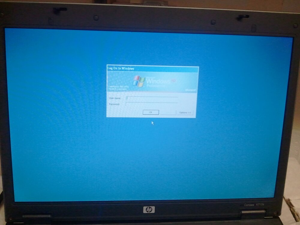

  12. had a bunch of ipads set up on the network before xmas with profiles installed to manage details. Now the WiFi settings seem to have forgotten the proxy and set itself to off. when I manually change it it just switches back to being off straight away. i have tried resetting the network settings and restarting the device, I'm going to try ressetting the device using power/home and see if that helps. really hoping I don't need to factory reset and restore all the devices that this is starting to happen on. any one experienced this issue with proxy on ipad?
