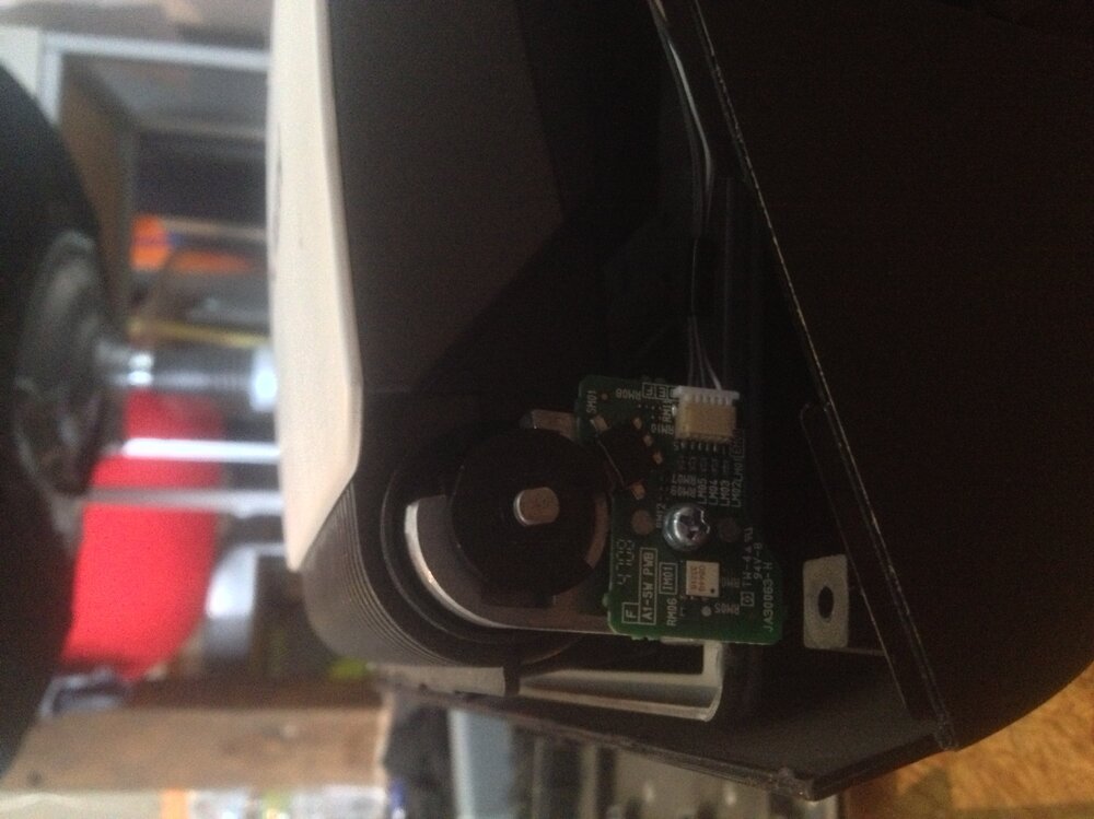

We have had this on several of ours, ED-A100 and ED-A110s, but unfortunately the warranties have now expired.
Having a dig inside the projector the problem appears to lie with a collar on the shaft which opens the reflector. The collar should be firm on the shaft and mate with a cog, also on the shaft, which is driven from the motor. The collar has cracked, meaning that it no longer grips onto the shaft in order to open the reflector.
Any idea where this part can be obtained without paying silly money for a repair? Presumably from the right supplier it should be less than a few pounds.
Diameter is approximately the same as a five pence piece.
[ATTACH=CONFIG]12307[/ATTACH]
Looks like a job for a 3D printer :)
Ben
