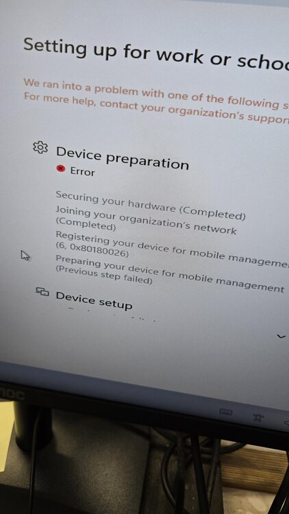

  6. Hi. Does anyone know how to bypass/skip the registering your device for mobile management when using sccm? Everything was working fine but now the process won't complete at it fails on this screen. It does the securing and joining to AD find but then the rest just fails. In SCCM the agent is yet to NO for automatically enroll. We're not using Intune or MDM so just want it to continue working locally for now? Anyone else had this and why its just suddenly happened? I'm assuming when the device checks for updates its pulling something down to do this. thanks
