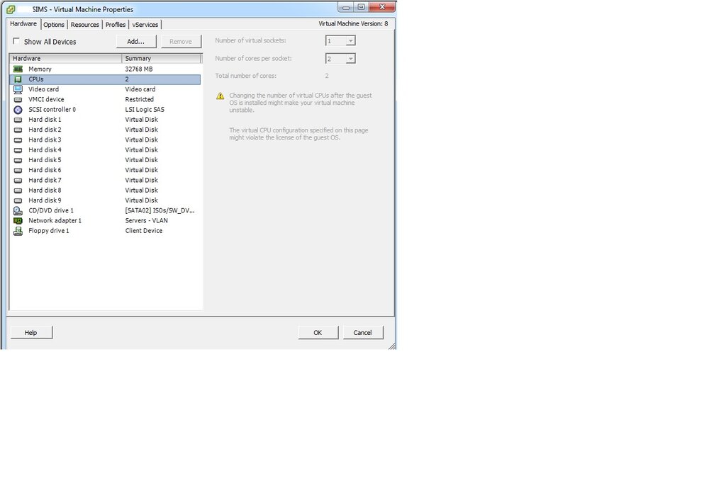

I opened the VCPU.jpgSphere console and Edit the SIMS server and under CPU- Number of virtual sockets =1
Number of cores per socket=2
So do i need to increase the Number of virtual sockets to= 2

I opened the V[ATTACH=CONFIG]35997[/ATTACH]Sphere console and Edit the SIMS server and under CPU- Number of virtual sockets =1
Woha?! Why so many disks?
Also would suggest you read this -http://blogs.vmware.com/vsphere/2014/02/vscsi-controller-choose-performance.html and look to split some disk onto a PVSCSI adapter
Also what type of Network Card do you have on that VM https://kb.vmware.com/selfservice/microsites/search.do?language=en_US&cmd=displayKC&externalId=1001805 again worth a read and ensure you have the most optimum and suitable model.
You should also look at the CPU usage and Ready state on the VM to check it isn't bottle necking due to other VMs on the host, if you give a VM 4CPUs it will wait till it is able to lock 4 threads on to process this adds wait state to VMs and can cause issues so if the box has a high ready state currently then other VMs on the host are hogging resources they probably don't actually need so reduce the vCPU on them to reduce the overall ready state and improve the performance of other boxes.
