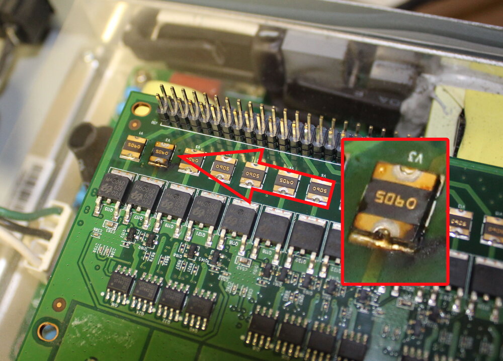

I found the faulty component. It's not part of the PSU but a separate PCB which looks like it is something to do with the PoE side of things as it has a 24V and 48V input on it. Even with this PCB disconnected the switch still behaves in the same way with the same port LEDs on constantly. I think I'll bin it unless anyone wants it for spares? Maybe I'll send it to Big Clive...

After almost 5 years of faultless service, one of my UniFi switches has died. No warnings, just dropped off the network taking every device connected to it down at the same time. All the port LEDs that were on at the time stayed on, but the main status LED is off. Power cycling it had no effect, but strangely the same port LEDs that were on before remain stuck on, even after disconnecting all the patch cables. The cooling fans also come on low speed at first then spin up to full after about 15 seconds. Pressing the reset button does nothing, even if holding it in for 5 seconds for a factory reset. The status LED remains permanently off. Looking on the forums there have been others with similar issues but I couldn't find a fix. I left it powered off over the weekend but trying it again today its just the same. As it's way out of warranty, the supplier just offered a link to buy a new switch. Has anyone had anything similar with a UniFi switch and managed to fix it?
