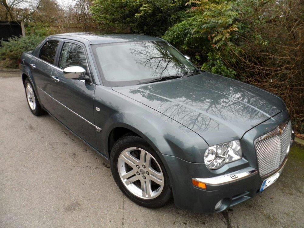

Upgraded recently from my MG ZT-T, to a 2007 Chrysler 300c (V8, 5.7L). I do very little mileage really, and it's all for pleasure, so the low mpg doesn't bother me..
[ATTACH=CONFIG]15994[/ATTACH]
