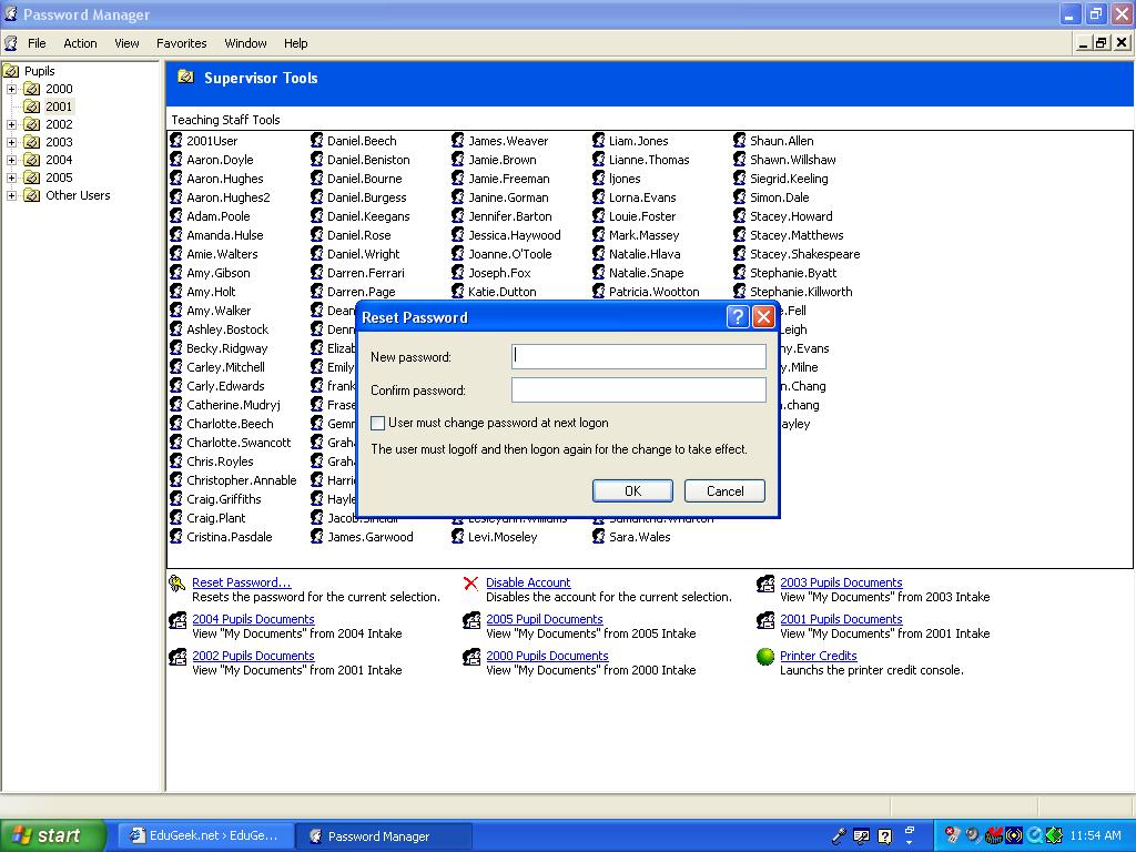

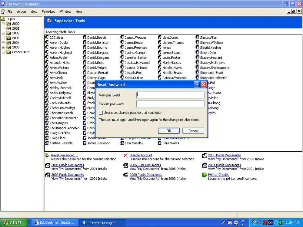

You do not need any of these software password managers. Windows comes with the stuff for a password manager for teachers. This is what i have on my Vanilla Windows 2003 Network with no extra software bits. (See attached photo) The tools come with Windows Server, i do not know why others are not using them.

I had to make it using the tools microsoft provide with Windows, took less than 5 minutes to make.
All you have to do is make sure the 2003 Server Admin tools package is on each workstation (MS do an MSI package that goes out via group policy), then click start, run, type in MMC.
That should give you a blank Microsoft Managment Console. Then add in the Active Directory Users and Computers plug in.
Once that is done click on your root pupils organisational unit and click "open new window from here" So Teachers only see what they need to.
Then on your new window, right click the root organtisation unit for the pupils and click "New taskpad view"
Now select horizontal list and style as text click, next and next until that wizard ends and a new one starts. Now you want a menu command, if you select a user account on the left, the menu commands appear for that object on the right, so select change password, give it a name and some text and an icon.
Now you will notice when you select a user the "Change Password" task appears in the task pain on the bottom :) . Now just click file options, give it a nice icon and a nice name, and bang you have fancy looking password manager for teachers. You can do what i did and add extra shell commands in too.
O, forget you need to delegate allow changing of passwords to the staff group!
