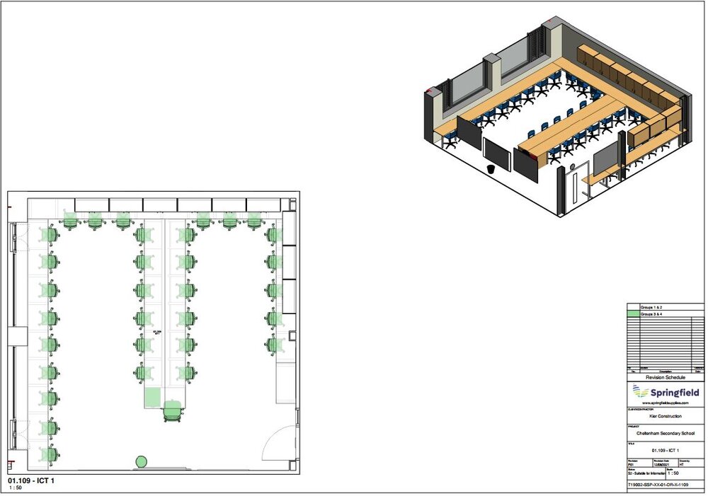

kennysarmy Posted February 28, 2022 Report Posted February 28, 2022 (edited) Proposed layouts for our new school. ABTutor will also be deployed so teacher can blank off student monitors etc. Edited February 28, 2022 by kennysarmy 1
localzuk Posted February 28, 2022 Report Posted February 28, 2022 Your corner ones will clash if they're as close together in the pic as they are in real life @kennysarmy.
kennysarmy Posted February 28, 2022 Report Posted February 28, 2022 Your corner ones will clash if they're as close together in the pic as they are in real life @kennysarmy. I'm hoping it's diagrammatical
simpsonj Posted February 28, 2022 Report Posted February 28, 2022 [ATTACH=CONFIG]64781[/ATTACH] Proposed layouts for our new school. ABTutor will also be deployed so teacher can blank off student monitors etc. We went with something similar, but with a 'Christmas tree' configuration so all the desks are at a 45 degree angle facing the front. Also make 100% sure that you have the power and network connections exactly where you want them!

browolf Posted March 1, 2022 Report Posted March 1, 2022 (edited) [ATTACH=CONFIG]64781[/ATTACH] Proposed layouts for our new school. ABTutor will also be deployed so teacher can blank off student monitors etc. Same for our new school being built. The head of ICT is not pleased at all. The design is set by the DFE Edited March 1, 2022 by browolf
