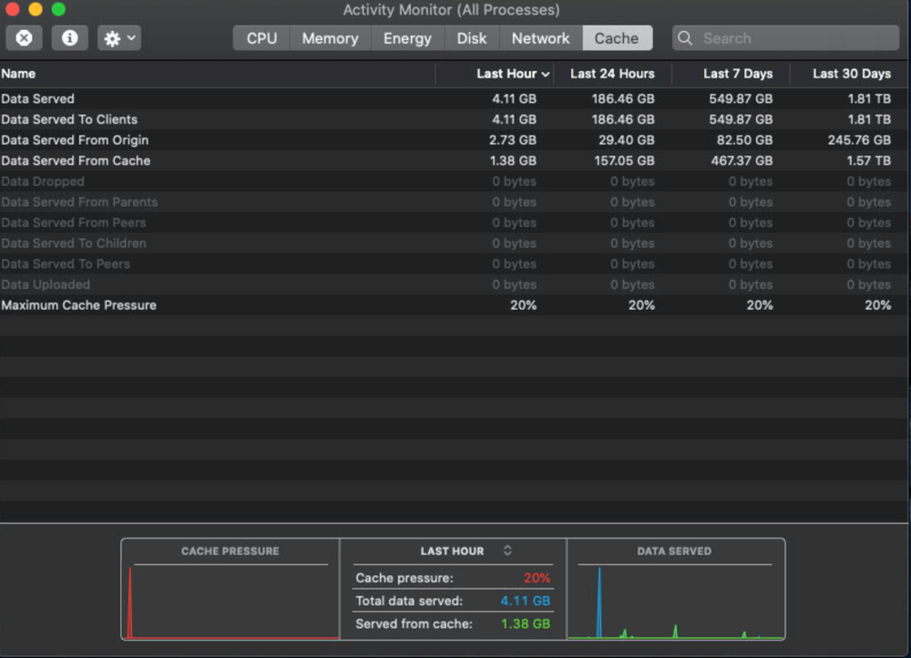

I know @Brimstone often mentions a caching server. Anyone know what exactly is needed and approximate costs?
Costs 1 Mac that you hardly use, or don't mind being used for storage of the cache! Takes all of 3? clicks to setup.
We've got a Mac Mini that we used to run Profile Manager. Now it just acts as the caching server. All it does is reduce the amount of data that devices need to pull down from the Internet. E.g. When a new iOS comes out, it gets downloaded once, then pushed out internally from the caching server. I'm not sure it will do anything about the issues listed above.

Server: https://smile.amazon.co.uk/Apple-mini-Chip-256GB-November/dp/B08N5NT8VF - is 256GB enough storage for the cache?
My best advice, get a cheap external usb/usb-c drive to connect to the Mac Mini, 256GB SSD is fine
