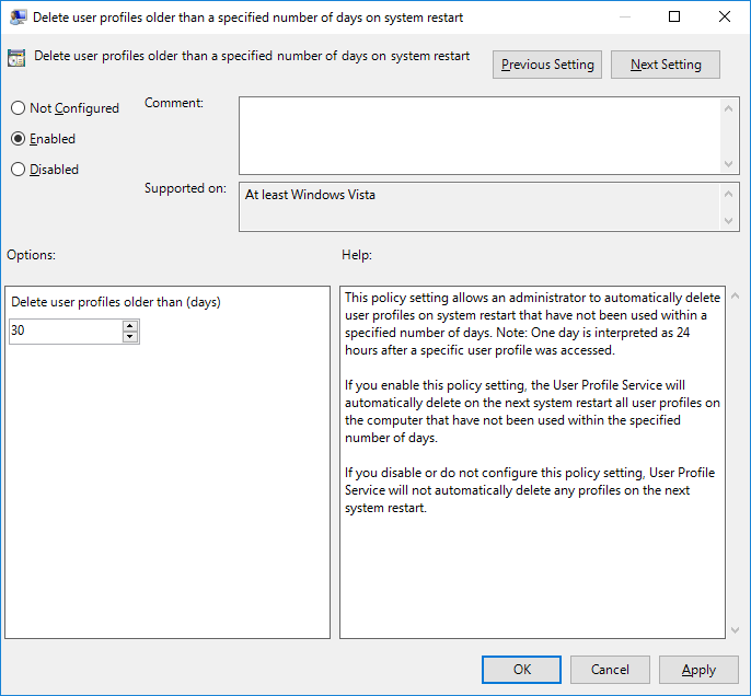

750 Workstations/laptops on 1803 without any issues. Main thing after running windows 10 from version 1511 throughout the school is that I found that success was all down to stripping the default apps from the .wim file and use a local profile. I have a rar file under and old Alfatec post which has all the required details for setting up Windows 10 in a school.
Local profile is a must these days I think. There are lots of bits of win 10 that MS state don't support roaming profiles any more (eg the Start Menu customisation).
Agreed. I think mandatory still works for some of us because it shares a lot of its functionality with local - just that a read only template profile is copied to the local location rather than a fresh one.
