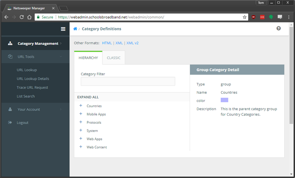

Blue_Cookeh Posted March 13, 2018 Posted March 13, 2018 I have to say we had two e-mails regarding Lightspeed upgrades - one at around 5pm on Monday 5th and an update at around 2pm on Wednesday 7th, so there was plenty of communication from our point of view. @SchoolsBroadband is this all we're supposed to be able to see in NetSweeper? I don't seem to be able to add any allowed or blocked URLs anywhere or modify our staff/pupil/default web filter groups:

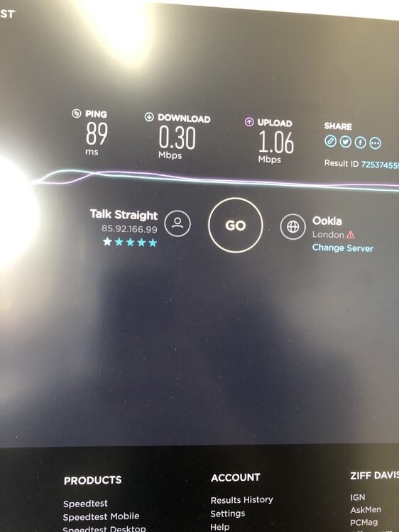

Nightshade2k Posted March 13, 2018 Posted March 13, 2018 (edited) You know im fast gaining the belief that im cursed in some way/shape/form, Part of me thinks i should just get a bigger pipe that or pray more Anyone else having any issues with TalkTalk Business today for speed or netsweeper speeds??? Edited March 13, 2018 by Nightshade2k
Nightshade2k Posted March 13, 2018 Posted March 13, 2018 Ok just weird. I give up its come back to life as if by magic... i need a holiday
SchoolsBroadband Posted March 13, 2018 Posted March 13, 2018 I suspect you were probably hammering your connection as that's what high latency normally indicates. Time to get a bigger pipe maybe No Talk Talk or Netsweeper issues on our network at all at the moment Dave
RobMason Posted March 13, 2018 Posted March 13, 2018 I have to say we had two e-mails regarding Lightspeed upgrades - one at around 5pm on Monday 5th and an update at around 2pm on Wednesday 7th, so there was plenty of communication from our point of view. @SchoolsBroadband is this all we're supposed to be able to see in NetSweeper? I don't seem to be able to add any allowed or blocked URLs anywhere or modify our staff/pupil/default web filter groups: [ATTACH=CONFIG]48060[/ATTACH] @Blue_Cookeh No, it looks like the correct permission template has not been applied. Please can you PM me the account you use to login to Netsweeper and I will sort it now.
Nightshade2k Posted March 13, 2018 Posted March 13, 2018 I suspect you were probably hammering your connection as that's what high latency normally indicates. Time to get a bigger pipe maybe No Talk Talk or Netsweeper issues on our network at all at the moment Dave No Dave not upload we were not, i had the SB support team check the router logs for upload speed... and we could not trace any IP's using that kind of upload in addition only 7mbs were being pushed upload wise on a 100 mb connection. Either way its resolved for now... frustrating.
SchoolsBroadband Posted March 13, 2018 Posted March 13, 2018 Sounds very odd indeed. As you can imagine the amount of data we upload on our network is tiny compared to the amount downloaded so that is strange. It's the high latency which normally indicates the line is being maxed out. If it ever happens again try ping the next hop in a traceroute from your gateway constantly (tracert -t x.x.x.x) and if you've high latency to that then it's either your link being maxed, a carrier network issue or one of our NNI's being maxed (highly unlikely). Feel free to get me involved if need be. Dave
FN-GM Posted March 13, 2018 Posted March 13, 2018 No Dave not upload we were not, i had the SB support team check the router logs for upload speed... and we could not trace any IP's using that kind of upload in addition only 7mbs were being pushed upload wise on a 100 mb connection. Either way its resolved for now... frustrating. Get SNMP monitoring setup so you can be sure either way. You can use free products such as Zabbix.
SchoolsBroadband Posted March 13, 2018 Posted March 13, 2018 We also have bandwidth stats via Talk Straight Dedicated Customer Portal if you don't have access please email CTS and they'll get this done for you. Dave
Blue_Cookeh Posted March 13, 2018 Posted March 13, 2018 (edited) @Blue_Cookeh No, it looks like the correct permission template has not been applied. Please can you PM me the account you use to login to Netsweeper and I will sort it now. The help desk fixed it very promptly after I told them it still wasn't right, thanks! As far as migrations are concerned I'm pretty pleased with it. Staff came in this morning after I'd flipped them back over to SchoolsBroadband last night and no one has complained about anything breaking. Computers are all proxying correctly and it looks like filter profiles out of the box are pretty good. Edited March 13, 2018 by Blue_Cookeh 1
RobMason Posted March 13, 2018 Posted March 13, 2018 The help desk fixed it very promptly after I told them it still wasn't right, thanks! As far as migrations are concerned I'm pretty pleased with it. Staff came in this morning after I'd flipped them back over to SchoolsBroadband last night and no one has complained about anything breaking. Computers are all proxying correctly and it looks like filter profiles out of the box are pretty good. Excellent to hear, Thanks,
