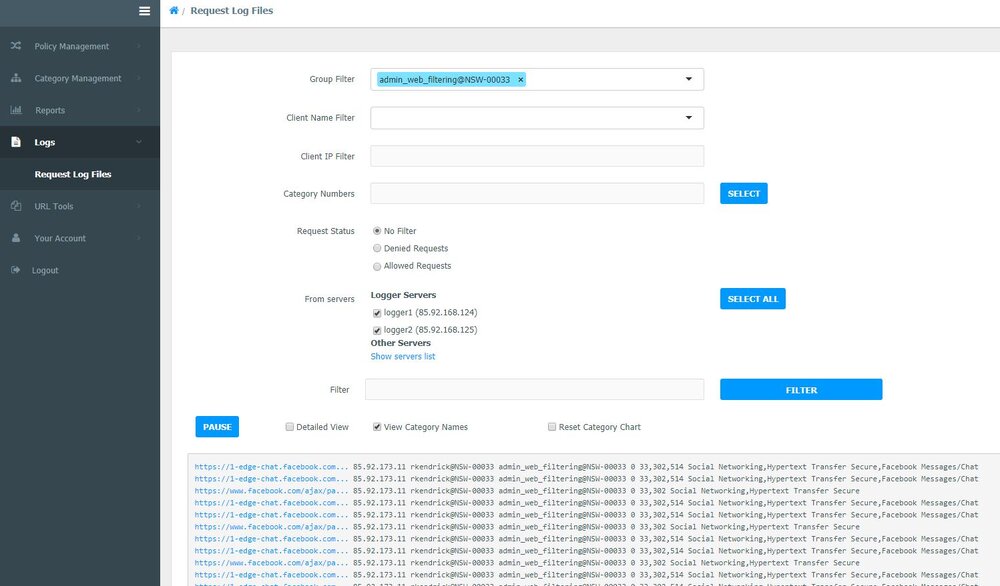

  11. Take screenshots of your lightspeed setup you may need them good luck and double check you have access to the loggers with support. on a side note anyone had any issues with netsweeper blocking their rd webfeeds internally>? cant see anything in the logger, got it logged with SB but thought i would ask

  13. Thats a shame i think you should of had it from the off Fiza i thought they had granted that to everyone! word of warning though the logger does not capture everything we have found, weve had to inspect the source code of the websites at times to see which CDN's may be getting blocked for certain sites. Best of luck in getting it sorted!
  14. And you have tried using the logger to watch the users live feed?
