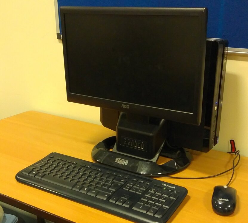

We have a few of the Stone UniStands in one of our rooms where we want to prevent tampering. You can use a standard Stone USFF PC, so any spec that you want. Cover goes on the back to protect the cabling, and you have USB, Microphone and Headphone on the front. Keyboard stands up on the bottom of the stand if you want to use the keyboard space for pen and paper.

Again, looked at the Stone Unistand - I think it looks hideous though.

Yes, it isn't the most attractive thing in the world, but it does have a desk bolt option to secure to the desk.
[ATTACH=CONFIG]41207[/ATTACH]
We had a demo of one of these but did n't like the fact you could n't blank off the USB ports on the front....
This, or drill through/hot glue the feet?
You could probably use the holes for attaching the feet, but I suspect you'd lose stability.
