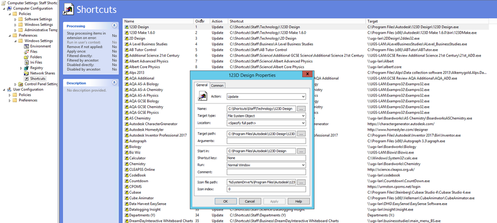

mdrabble Posted August 15, 2017 Posted August 15, 2017 @robsonma - I use 2 start menus, 1 for Staff and 1 for Students - the process is the same for either (does mean a bit of duplication - copy and paste seems to work ok) Here is my Staff Start Menu - I tend to use Notepad++ for any manual editing of the XML file and choose XML as the filetype when saving. StaffMenu.XML xmlns="http://schemas.microsoft.com/Start/2014/LayoutModification" xmlns:defaultlayout="http://schemas.microsoft.com/Start/2014/FullDefaultLayout" xmlns:start="http://schemas.microsoft.com/Start/2014/StartLayout" xmlns:taskbar="http://schemas.microsoft.com/Start/2014/TaskbarLayout" Version="1"> Created shortcuts for all my applications within GPP, that way only installed applications will have the shortcuts generated. - once I had done 1 complete set of shortcuts I then backed up the GPO and then imported into the Student ShortCuts GPO and removed staff shortcuts to things like SIMS.net etc. - When I need to add new shortcuts, it just a case of adding to one and then copy and past into the other. GPP for Shortcuts: Computer Configuration -> Preferences -> Windows Settings -> Shortcuts (See Screenshot) Start Menu Redirection Group Policy: User Configuration -> Policies -> Folder Redirection Settings: Basic - Redirect everyone to same location Target folder location: Redirect to the following location Root Path: C:\Shortcuts\Staff StartMenu XML Group Policy: User Configuration -> Policies -> Administrative Templates -> Start Menu and Task Bar Start Layout -> Enabled Start Layout File -> \\Server\Shared\StaffMenu.XML Hope that helps. 3

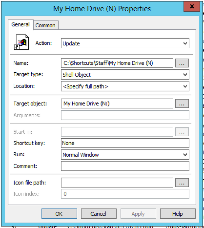

robsonma Posted August 15, 2017 Posted August 15, 2017 Thankyou Soooo Much for that, I am now about 60% of my way through it, I am Stuck with the Mapped User Drives, Users have Drive N:\ as their Documents folder, I have added, [color=#333333][/color] in the XML file, Created the Shortcut in GPO but I think this is wrong, Screen Shot Attached I think the Rest is going well, adding one shortcut then testing on VM. Nearly there! lol
mdrabble Posted August 16, 2017 Posted August 16, 2017 I installed RSAT tools on my desktop and then used Group Policy Management from the Desktop to create the shortcuts for the Mapped Drives.

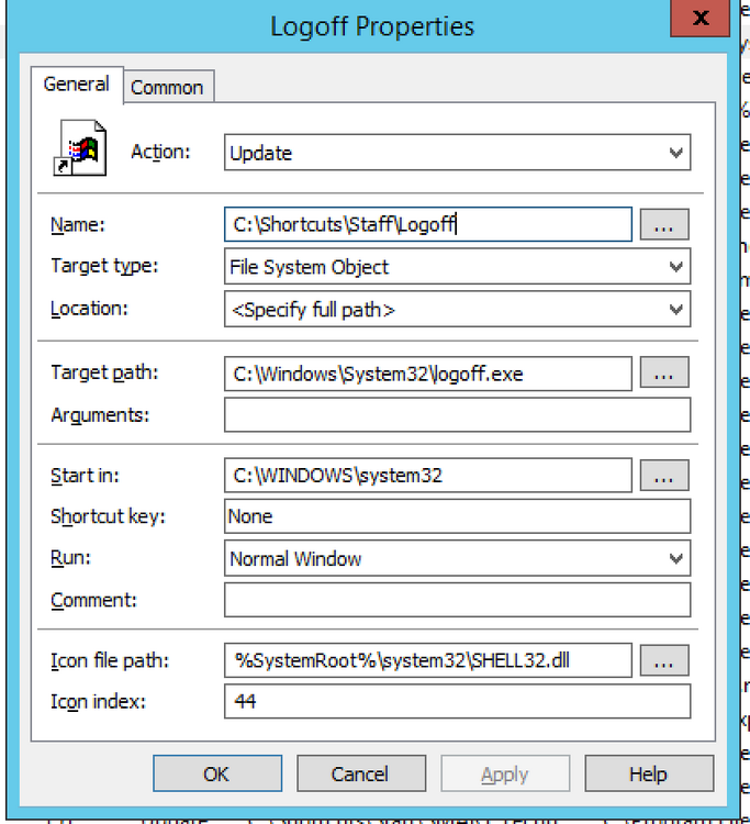

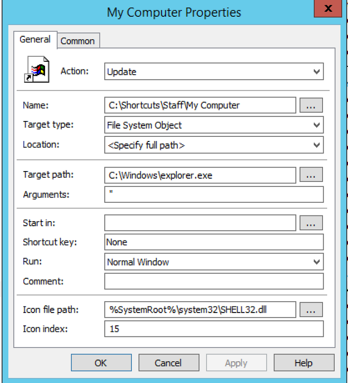

mdrabble Posted August 16, 2017 Posted August 16, 2017 @robsonma I found trying to create the shortcut using N:\ didn't work. I downloaded RSAT tools for Windows 10 and installed on my Desktop - this gives you access to AD Tools such as Group Policy Management where you can then create the shortcut for mapped drives. Mapped Drives - you will need to do this for any drive you want to pin to the start menu. In your GPO for the shortcuts, Create a new Shortcut Change Target Type to Shell Object On Target Object, click on the 3 dots and then click on your mapped drive See screenshot for reference: For Log Off - copy details in screenshot My Computer - note the Argument area is a " Shutdown, I don't add this as a pin but on the start menu but it is on the start menu as normal. Let me know if you need any other info Cheers 1
sparkeh Posted August 17, 2017 Posted August 17, 2017 (edited) How did you Manage to get your Drive Maps to Show? Cant get them to show at all! Also How do i get the Log-off and Shutdown to show Spent 2 Days and now I' Stuck! and ready to give up @robsonma here's how I did drive maps. First of all I created the drive mapping in a GPO and then a shortcut to the drive mapping. I actually created an msi which runs at OS deployment and puts the shortcuts in the right place (for me the %allusersprofile% startmenu) before the first login. I then added the following to the xml Off the top of my head, I would think that you have to add the shortcut to the %allusersprofile% start menu - as I understand it, there is a database that contains the DesktopApplicationID's and when you add a shortcut to the %allusersprofile% or your own profile's start menu it generates the ID. So when I add the U:\ shortcut it generates the ID "U:" which you can use in the xml. If you put the shortcut anywhere else it won't know about it when you call it. At least that's how I understand it. Edited August 17, 2017 by sparkeh 2
sparkeh Posted August 17, 2017 Posted August 17, 2017 @robsonma Oh and for logon and shutdown I created these shortcuts Again, these shortcuts when in the %allusersprofile% start menu and got the app IDs (which was 'log off' and 'shutdown') and added this to the xml
