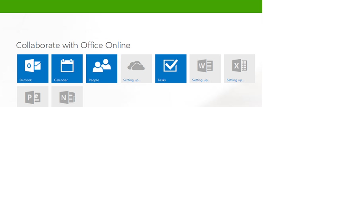

Hi,
Can anybody advise me on the screen print. My O365 is set up and all aspects seem to be working mail, calendar and the ability to download the software as offered etc etc. Just trying to work out what is going on with the various options that seem to be stuck at "Setting up" against Word, Excel. Powerpoint & the cloud at login. The few test accounts that I have tried are getting this when they log into the portal. Not sure what it is trying to set up? Office is installed on the PC. Any advice gratefully received!!

O365setuperror.docx

Thanks for the quick reply. I have tried that with three test accounts and all have the same message. Is it worth contacting Microsoft? Cheers!!
Can't help with your problem, but thought I'd add I've had some great service from Microsoft support when we had an issue with address book policies and O365, so they should be able advise.

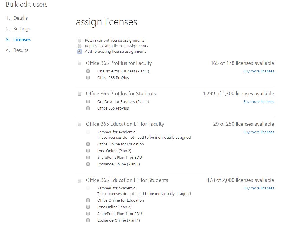

Not sure if this will help you at all Gareth, but...
We use the Office 365 admin portal to assign email and or Office 365 licences, we have 2 email accounts linked with our 365, a schoolname-school.net and a schoolname.county.sch.uk, these are set in the AD Attribute Proxy Addresses, synched with 365 via synchronisation service manager. When a student logs on, they get offered the chance to install Office (if we assign the proplus licence) on whatever device they are using. Not sure whether this would work alongside Google for Education though.
