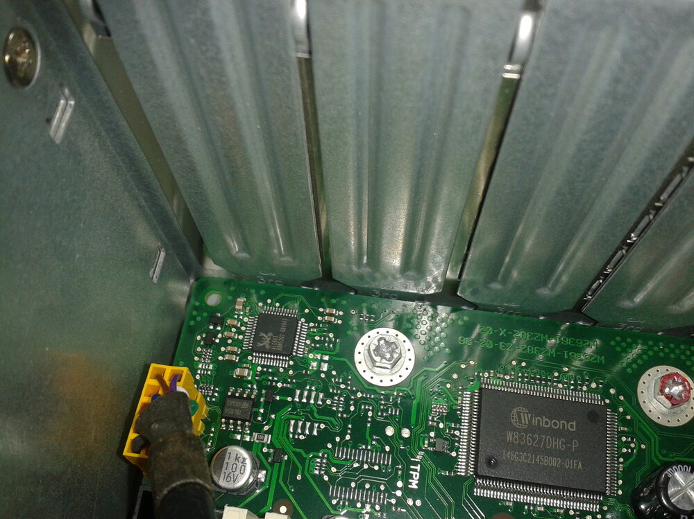

I'm starting think it is something to do with the case. Something is affecting the MB. I had look inside the case and noticed the PCI slot blanking plates are quite close to the MB (see pic)2013-05-23 08.04.22.jpg. There is probably 1mm gap between the edge of the MB and the case, and I can get a piece of paper inbetween them. It could be that others are actually touching the MB?? I did remove the blanking plates from 3 of our biggest offenders last night, but this morning 2 of them were at it again, or could the damage have already been done previously. Also I don't know if this is a factor or not, but sunlight shines directly onto the cases in this room. The PC's affected do seem to be in the line of direct sunlight but I could be talking complete crap. I have moved the PC's around the room and it seems to be the same ones.

I'm starting think it is something to do with the case. Something is affecting the MB. I had look inside the case and noticed the PCI slot blanking plates are quite close to the MB (see pic)[ATTACH=CONFIG]18348[/ATTACH]. There is probably 1mm gap between the edge of the MB and the case, and I can get a piece of paper inbetween them. It could be that others are actually touching the MB?? I did remove the blanking plates from 3 of our biggest offenders last night, but this morning 2 of them were at it again, or could the damage have already been done previously. Also I don't know if this is a factor or not, but sunlight shines directly onto the cases in this room. The PC's affected do seem to be in the line of direct sunlight but I could be talking complete crap. I have moved the PC's around the room and it seems to be the same ones.

I've looked at the capacitors and none of them are bulging or anything other than flat. Also we've had 6 MB's replaced and since then 5 have reoffended and yes Fujitsu have tried the PSU + MB at the same time and it still happens. The bios is up to date, so nothing to change there. It is like something is affecting the MB. I left the 3 usual suspects on (after school) yesterday (they do a normal shut down later on) and this morning on power-up 2 are not booting. Some time later today, they will decide that I can boot them again.
