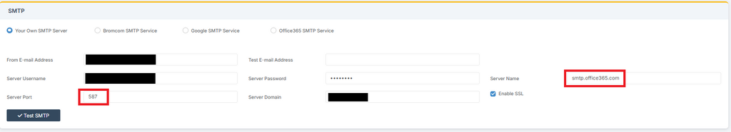

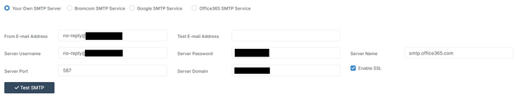

  2. We're (still) using it fine with O365 SMTP configured old-fashioned stylee manually with Basic auth, rather than the newer "proper" intergration. **shrug**

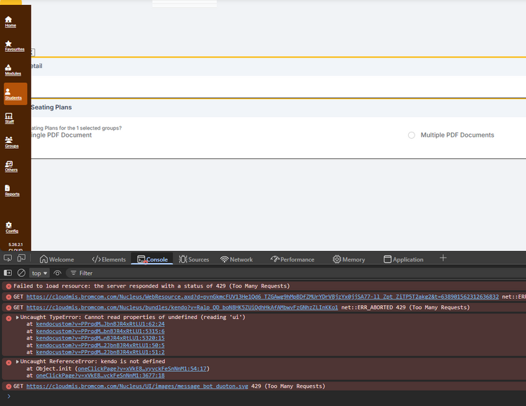

  14. By the looks of things they're subdomaining bits out... eg: CloudMis odata now gets syphoned off to misodata.* (this was put in place during the last round of 429s back in Nov I think) Bits of CloudMIS itself randomly get redirected to appsapi.* (this has started happening since the current mitigation was put into effect) ...gives them finer grained traffic shaping / resource provisioning etc rather than the one overarching set of rules / restrictions applied at cloudmis.* level applying to everything passing thru that front end request router, as well as redistributing the load in general. I suspect the knock on effect of this is impacting endpoints used by the mobile apps etc Same is happening within bits of CloudMIS eg: builtin reports all fail if you happen to end up on the appsapi.* URL via signpost-switching across schools as can't CORS across to the reporting engine at mis-reporting.* (workaround: logout, log back in, go direct to school in question. Pretend the signpost-switcher doesn't exist) Minification still fails on majority of generated css assetts and bloats them up to be larger than if minification was never attempted due to the debug output being written into the final delivered files (always has).

  16. It's still struggling this morning, with 429 errors showing in DevTools console...
