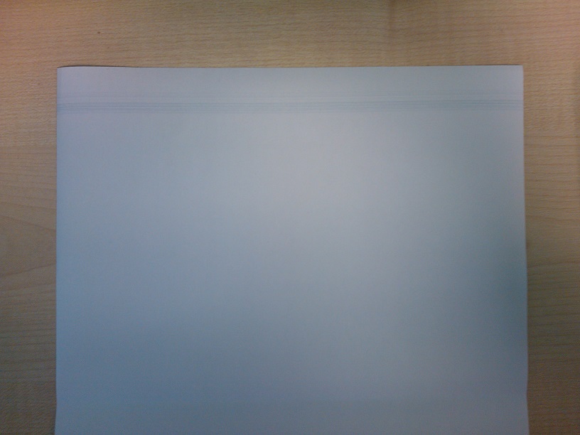

There were no visible marks on the tranfer belt, we even gave it a thorough air-dusting but they still appeared. Fortunately we have one in IT Services so we swapped it over with the one in that and the lines disappeared so problem solved!

Any ideas what might be causing this to happen on a HP Colour LaserJet 5225n? I've removed the toners and cant see anything on the OPC drums and I've swapped the fuser unit over with one from another printer of the same model and it's still printing these lines at the top of the page.
