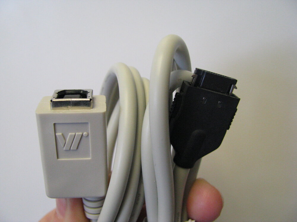

Anybody know the name of the lead...
TRobinson replied to LeMarchand's topic in Promethean Direct Support
Just keep in mind though that some of the very early first generations are "serial" only so if you are hoping to convert a system that has been previously used serially then its best to ask our support team if yours has the USB chip - they should be able to tell you this from the serial number. If it's simply to replace existing then Happy Days! -
This sounds like the USB adapter for the 1st generation of ActivBoard - is this it? If so it is available via the PrometheanPlanet shop, it is also supplied with a Standard 5m cable.ActivBoard Cables (USB Cable for ActivBoard 75
