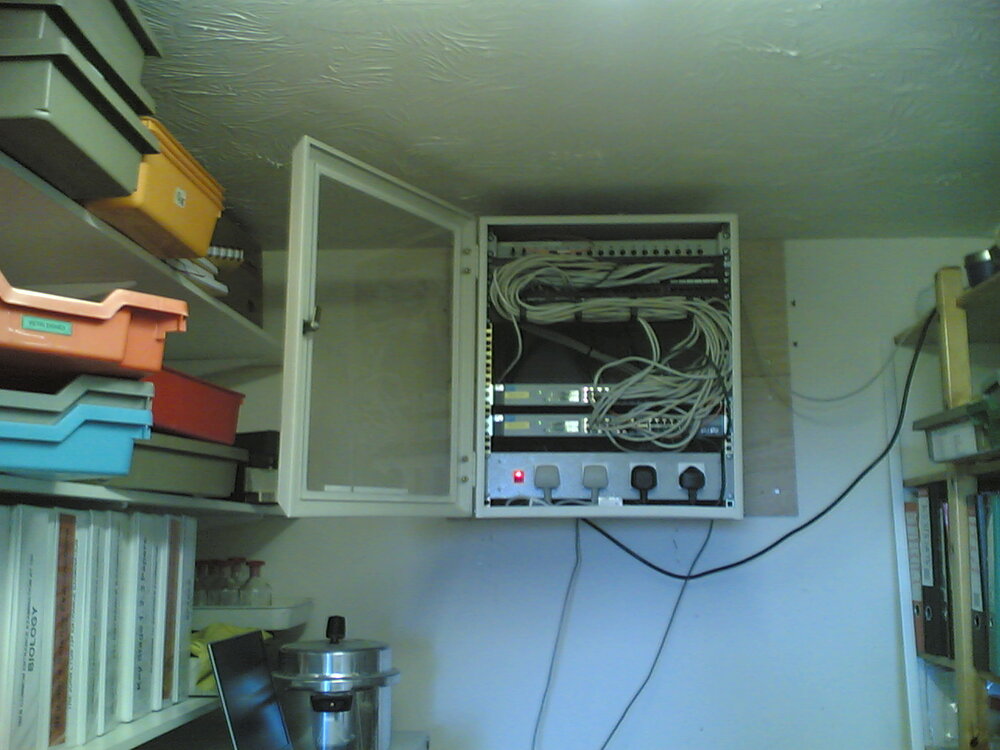

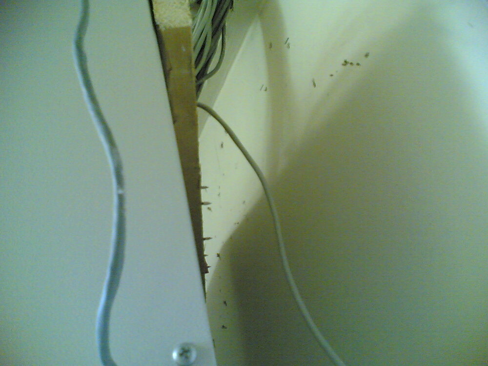

Then all of a sudden it started, the cabinet starts to come away from the wall - me thinking, :censored:it !!! There is a quite a deal of expensive kit in there starts to try and hold it, I scramble down and start to take the weight on my sholders, feeling my back tingle I manage to reach for my phone, praying Mark [ our maintenance chap ] has his switched on I ring....
Thank god he answers - I tell him the situation I am in and that there is no way I will be able to hold the cabinet for much - he legs it up to the science block sees the situation I am in, rushes over and helps take the weight.

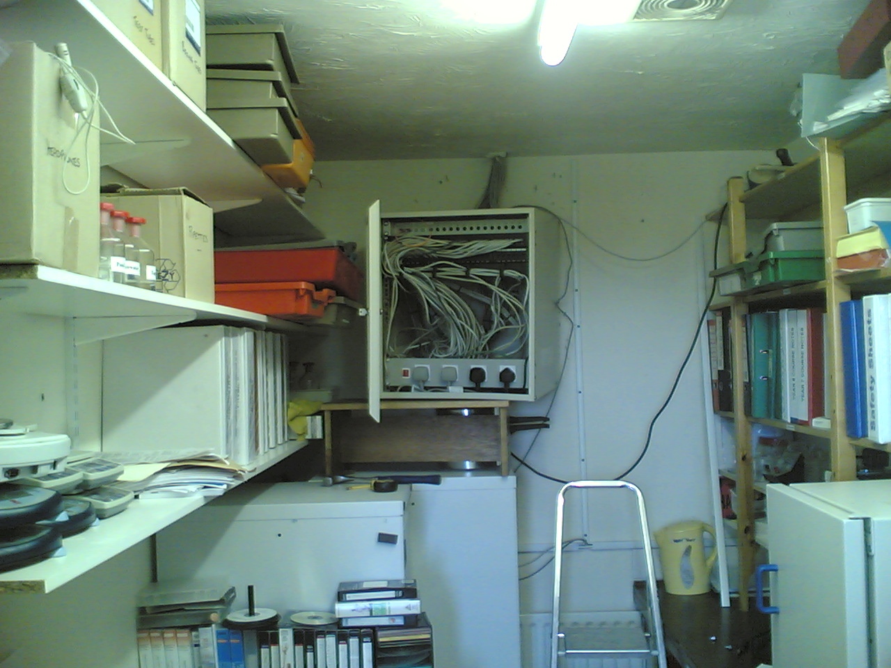

We then manage [ whilst holding up the thing ] to pull over a filing cabinet and use the pressure cooker to prop the thing up.....[ You can just see it behind the other wooden shelf thing we found to also take some weight ]
My back is still twinging now......
Laugh at the pictures - I do.....

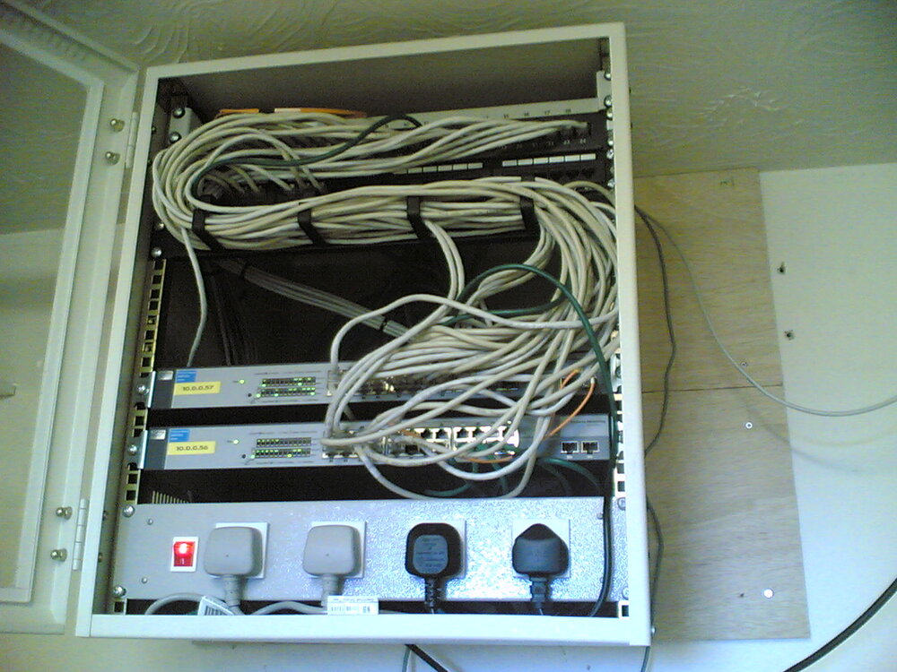

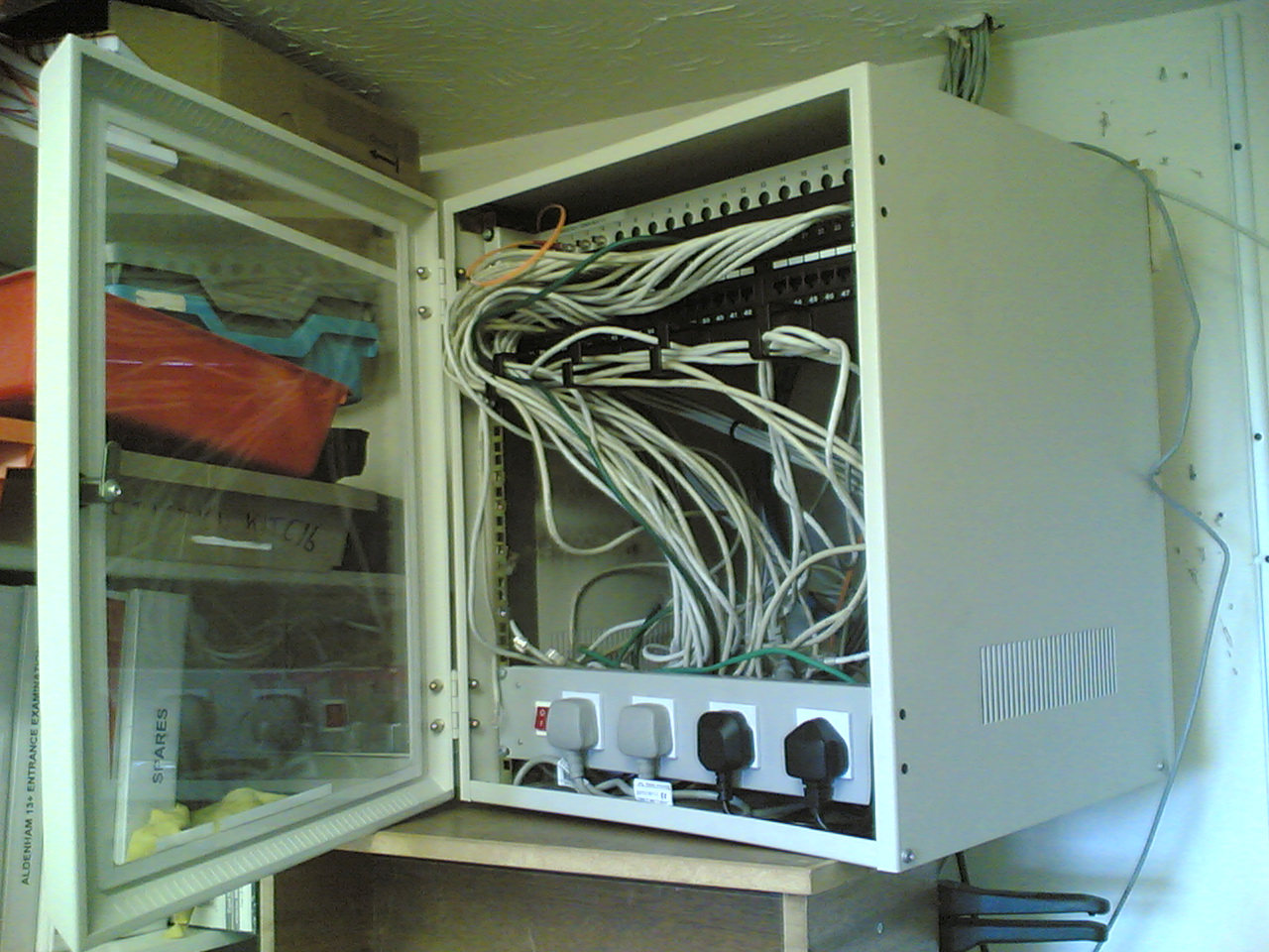

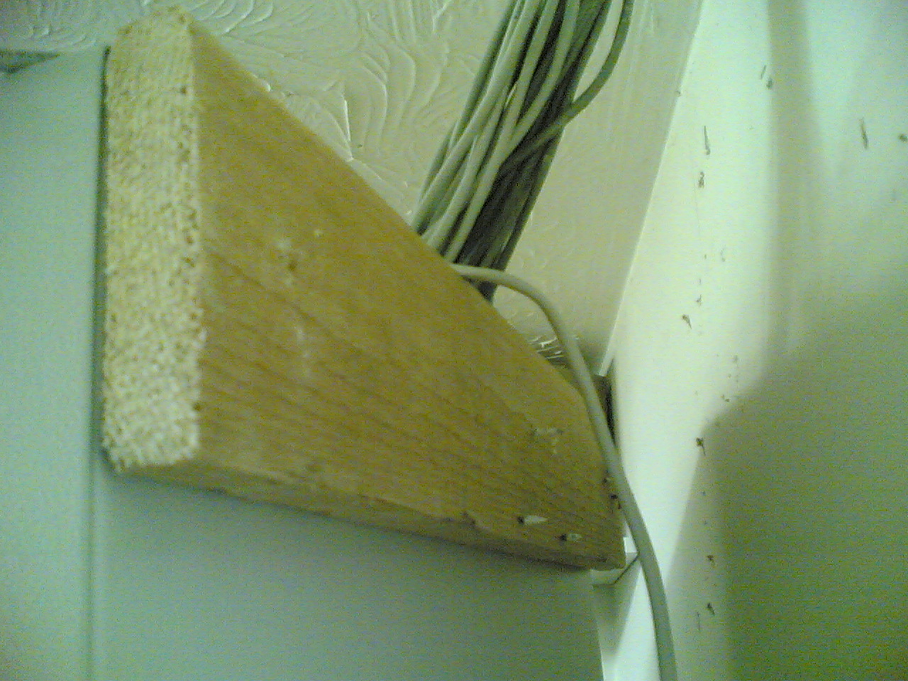

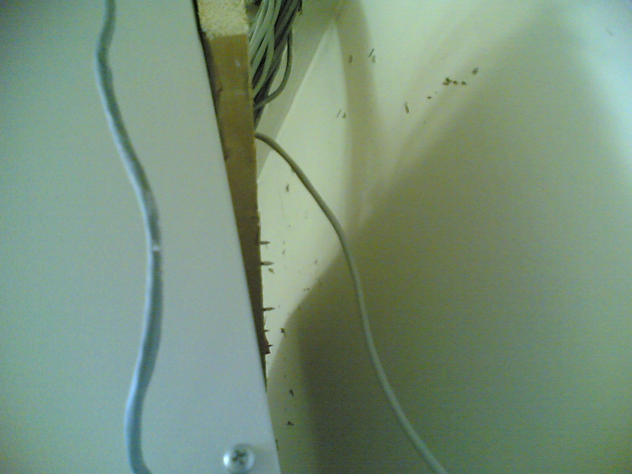

pix 2 and 3 show just what was holding the cabinet on the wall - Hmmm, I would like to meet Mr Cowboy who put this up.......

I had a similar thing happen to me about 2 years ago. The cabinet was held up by 4 screws into plasterboard it held 3 switches, patch panels, 3 cable tidys it was right above my desk as well. It only fell of as i had my had inside trying to grab a cable from the back that i had dropped in the top! I managed to shout to my colleague for help and we had 2 engineers on site in the room of the office so we shouted to them for an hand so the 4 of us proceeded to take the cabinet apart to get the units out of it. 2 years later the switches are still on the shelf and tied round a pipe with network. Its now just a store room so its not to much of a problem!!
That is a nasty install, who nails up a networking cabinet?
@webman - just don't let him build his own hanging tower or it won't do much good.
Had a simelar one when I first started at my last school it was supported on an old filing cabinet for almost a year until we brought a nice floorstanding cabinet and re-wired the lot into it. I don't trust wall mounted cabinets with a lot of heavy kit in, I always try and have floor standing ones where possible.

That looks remarkably like a lot of the installs we had at our school until recently. Even down to the Krone patch panels and that sunk in fibre tray. Not in the SW are you?

Had a similar thing happen here, lucky there were 2 of us working in the area. was probably 1 of the oldest small cabs we had from a previous company we got to do our installs. Thing had tiny screws to hold it up!
our current installer does the monkey bar test. If it doesn't hold his 15 stone in weight while hanging off it then its not good enough :eek:

That happened in a council office in my LA - the consequence was that they had to send a chap around to ALL council buildings including schools to see which ones were installed with dirty great wall bolts of just 4" screws. They wanted to re bolt al the ones that were screwed in.
Out of our 10 cabs only 2 were install 'safely'. I suspect that all schools/offices were in the same boat. I've not heard back yet :D
