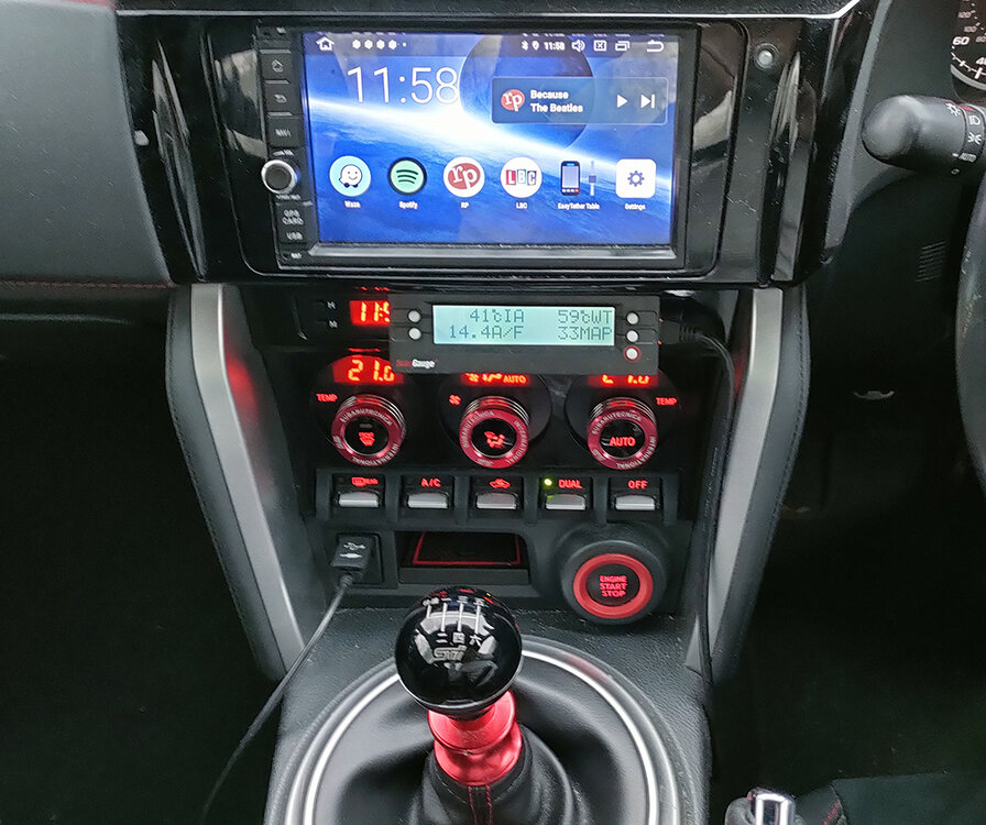

I now just tether the phone to provide an internet connection. Waze, Spotify, Radio Paradise etc. all run natively on the Android screen and are presented far better than a mirrored view optimised for the phone. Phone/Teams/WhatsApp calls still integrate perfectly into the car's hands-free audio and microphone connection and display nicely on the screen. I can still answer using the steering wheel controls, which integrate using an App called WheelKey with the Eonon.

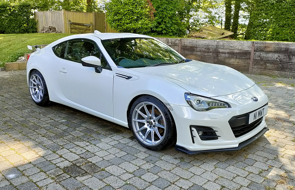

More importantly, I need to see more of your WRX @MartinT
Edited by Danp
Hah, hah, everyone gets caught out by that! It's actually a BRZ with a few additions (Harrop supercharger being the main one).
Oh wow, ok, now you really have got my attention!
You're welcome to see it if you're ever near Basingstoke.
I often go to car meets with fellow BRZ/GT86 owners.
Edited by MartinT

Looks lovely! A bit too far to pop down, but thank you.
