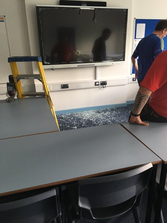

A contractor working the other side of the wall was trying to drill through the wall and into the trunking below the interactive TV.
I suggested taking the trunking cover off and drilling from the classroom out.
I left the contractor to it and was sheepishly called about an hour later to come to the room because the TV “exploded by itself”.
Not a good day that one!
[ATTACH]61929[/ATTACH]
[ATTACH]61930[/ATTACH]
Is the floor a different level on the other side of the wall? Can't understand how they got that so wrong (not that it would have been better if they drilled into the bottom of the screen instead of the middle).

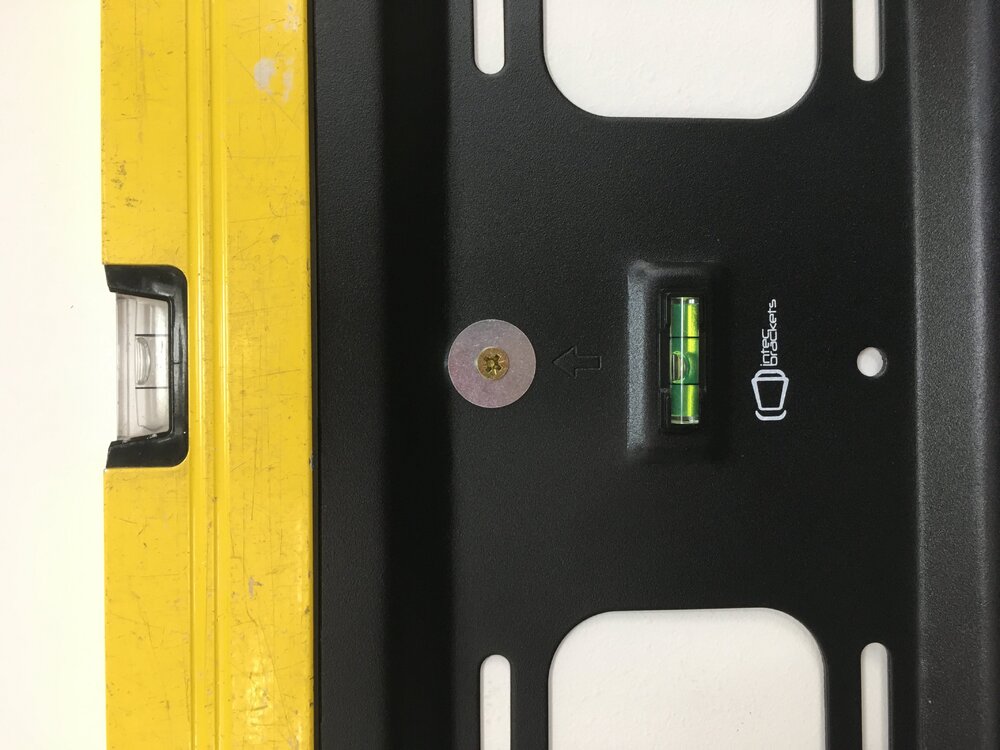

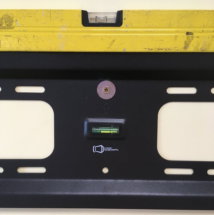

have install well over 1000 of the activ panels, as a lad said to me there is level and then real world level, sometimes you have to offset them as the whole room is slightly off level, but yeah never ever use them built in levels on any mount , still don't know how a bubble can lie😄😄
have install well over 1000 of the activ panels, as a lad said to me there is level and then real world level, sometimes you have to offset them as the whole room is slightly off level, but yeah never ever use them built in levels on any mount , still don't know how a bubble can lie[emoji1][emoji1]
Check your spirit level regularly...
