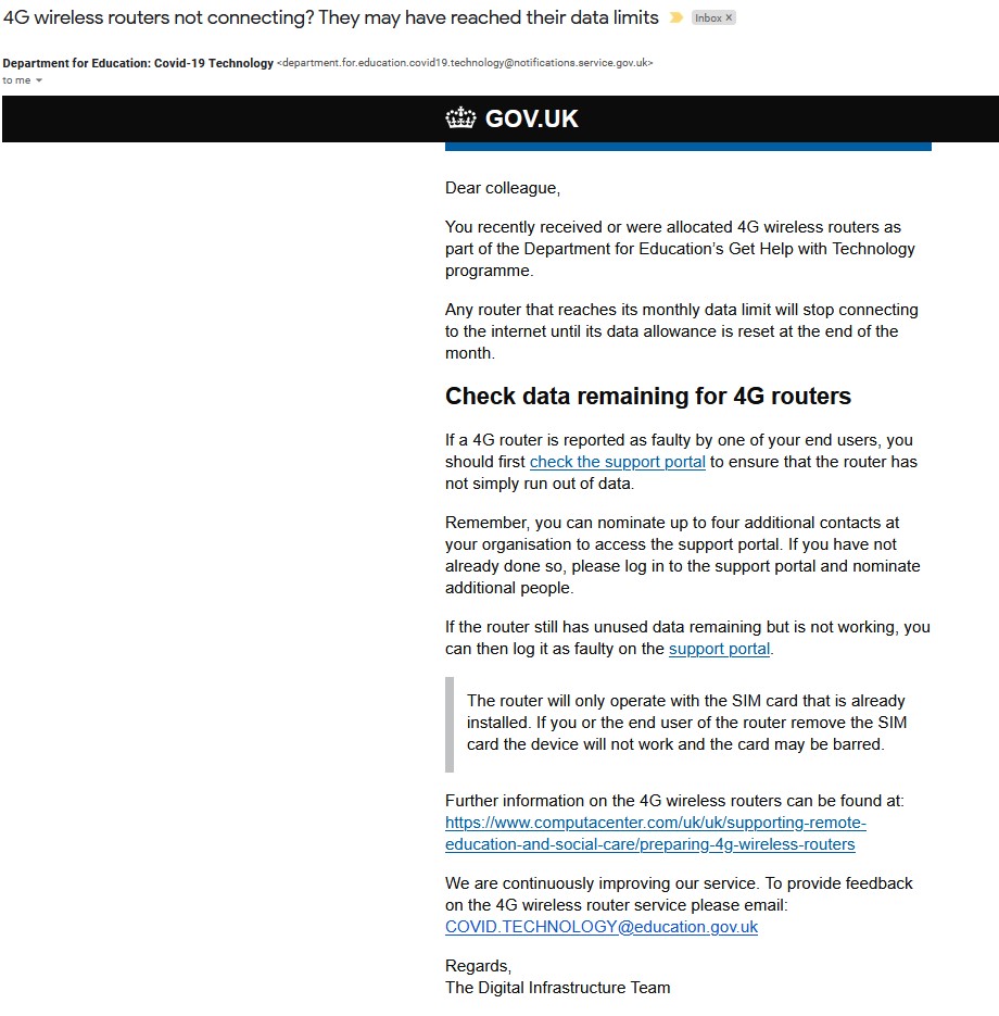

...and so it begins
You (The UK Govt) gave children a 4G connection on their laptop and didn't expect them to use things like video on the paltry data allowance? Video that your own "National Academy" website uses liberally?

...and so it begins
I've just got that email too. Does anyone know how to get a login for the portal? I tried the details I used when placing the order, but those don't work. I also tried the forgotten password option, as I think that was how you had to register for the ordering site, but it said I don't have an account.
Exactly the same here! Can’t get on.
does it say what the data allowance is anywhere?
6GB per month for 6 months. No word yet on how to extend it beyond the 6 months.
