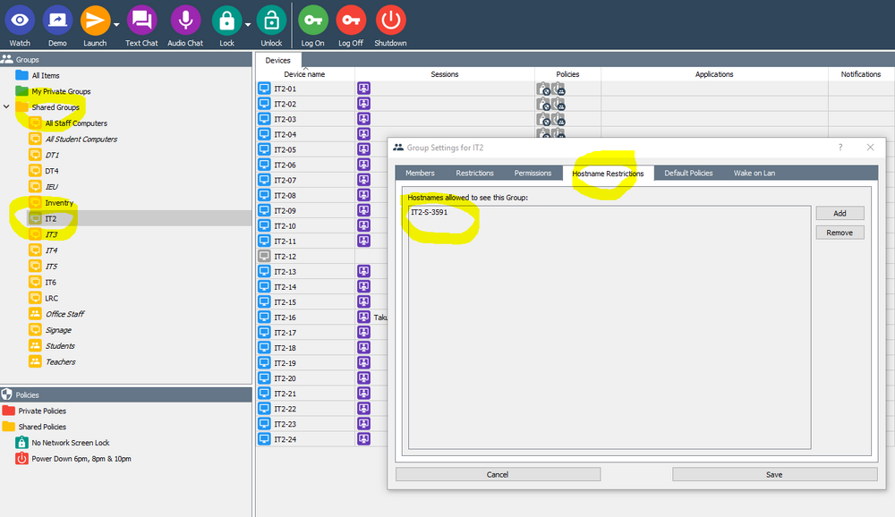

So far can't see a way to setup the clients so that they ONLY see the PC's in the room.
If you right click on the "Group" that contains the computers, then under "host name restrictions" enter the name of the machines you want to access this group.
in our case is the staff machine in that room.
Admin users always have access
if you dont have a machine listed, every machine with the tutor client can see them!
[ATTACH=CONFIG]56681[/ATTACH]
Thanks :) just got to that part in the manual myself but cheers - you always read the manual after the event right? ;)

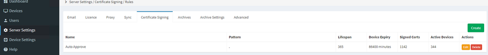

I thought testing was going well.
Pushed out the client MSI to a room.
Devices were appearing waiting to be authenticated - those that were were then automatically put in a room group based on an AD sync which I ran. All good.
Then I ran the AD sync again and all but the last clients to be authenticated have been removed from the group....can't work out why?

you might need to increase the certificate signing life expectancy in auto approve.
also check under devices---merge for any duplicates.
[ATTACH=CONFIG]56682[/ATTACH]
Hi,
I don't want to auto-approve as some of the OU's I'm syncing with have non-student devices in them which I don't want sync.
Under devices I don't see any duplicates, on the right hand side is just a list of my devices under the heading "Unmatched"....it shows the 5 devices that have been removed from the group and the 1 that remains.
I made no changes.
A few more of the PC's in the test room picked up the MSI, I approved all of them, ran the AD sync again and the count went from 1 to 21! Even though 6 were already approved. Bit odd!
