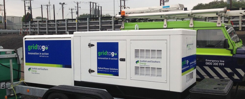

The other thing is - what make and model generator(s) are they planning using to keep the school running? I'd expect the generators needed to run a secondary school to actually arrive on the back of a large lorry. If the boys turn up in a pickup truck with a hand held 3kw one from machine mart then your plans to keep everything on are in severe trouble.

...The other thing is - what make and model generator(s) are they planning using to keep the school running? I'd expect the generators needed to run a secondary school to actually arrive on the back of a large lorry. If the boys turn up in a pickup truck with a hand held 3kw one from machine mart then your plans to keep everything on are in severe trouble.
Can't remember the make/model of 'our' generator (while not an exact match for size, it conveys the idea)
[ATTACH=CONFIG]54187[/ATTACH]
That looks like an approx 30KW generator with extended run time fuel tank.
30KW doesn't actually go very far when you start adding up how much your servers and all switches and other POE equipment uses. That's not even considering any lighting or heating, or if just one person plugs a kettle in.
I guess the real question is is the generator going to run the entire school, or just all the IT equipment? IF it is just IT, how are you going to stop people plugging things in and turning them on?
I think the generator was mainly for the alarm system and cctv, and then the servers. But since the prevailing opinion is leave them off, no longer the servers etc. I think no staff will be allowed in.
