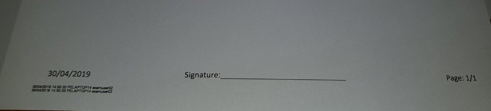

Carrot63 Posted April 30, 2019 Report Posted April 30, 2019 Hi We are just about to use this for our Exam season and it looks very useful thank you. I have done a test print and below the bottom line with date page and signature are 2 lines that have the date, time, computer name and username printed. Is there something in the config that can prevent this or does anyone have any ideas what is causing it? Thanks
ass17 Posted April 30, 2019 Author Report Posted April 30, 2019 Hi We are just about to use this for our Exam season and it looks very useful thank you. I have done a test print and below the bottom line with date page and signature are 2 lines that have the date, time, computer name and username printed. Is there something in the config that can prevent this or does anyone have any ideas what is causing it? Thanks Screenshot please?
Carrot63 Posted April 30, 2019 Report Posted April 30, 2019 Hopefully that will show you the bottom of the page.
ass17 Posted April 30, 2019 Author Report Posted April 30, 2019 [ATTACH=CONFIG]53227[/ATTACH] Hopefully that will show you the bottom of the page. Great thanks That information is not part of EWP, it’s being sent out via the Printer driver itself. Look at the font used to print it, it’s different to that of EWP. Is the printer a local USB or networked one? Reason I ask is to use a different printer just to prove the point.
6Foot2 Posted April 30, 2019 Report Posted April 30, 2019 Impero (and I think, PaperCut) can do this. Do you run either of these?
