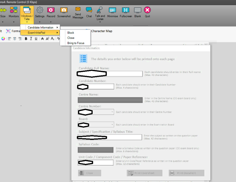

MrWu Posted June 3, 2019 Report Posted June 3, 2019 Do you have Top Most Priority enabled? I had the same issue when we first started using EWP and I found this to be the cause. Switching DisableTopMostPriority to 1 fixed it for me. Hi Thanks for the suggestion, have set this up on half the PCs in the room to test. I have captured one of the laptops giving trouble and it seems theres no Print Document screen behind Examwritepad, it freezes but running Impero it seems there's no print dialogue appearing so the screen remains greyed out, anyone had this behaviour before? thanks all!
ass17 Posted June 3, 2019 Author Report Posted June 3, 2019 Hi Thanks for the suggestion, have set this up on half the PCs in the room to test. I have captured one of the laptops giving trouble and it seems theres no Print Document screen behind Examwritepad, it freezes but running Impero it seems there's no print dialogue appearing so the screen remains greyed out, anyone had this behaviour before? thanks all! [ATTACH=CONFIG]53636[/ATTACH] Not seen this before and what is interesting is that the boxes are all empty. You cannot print until the boxes are filled in, until all the boxes are filled the print dialogue window will not appear.
MrWu Posted June 3, 2019 Report Posted June 3, 2019 Not seen this before and what is interesting is that the boxes are all empty. You cannot print until the boxes are filled in, until all the boxes are filled the print dialogue window will not appear. Ah I blanked out the boxes for privacy, all boxes were filled in.... so the Windows print dialogue won't appear until the Exampad box has been filled in properly..I willcheck...
Cthulhu Posted June 3, 2019 Report Posted June 3, 2019 Ah I blanked out the boxes for privacy, all boxes were filled in.... so the Windows print dialogue won't appear until the Exampad box has been filled in properly..I willcheck... Also something to note, I've had issues printing when I customised some of the items under Exam Boards. I reverted the options back to default and printing worked fine.
ass17 Posted June 3, 2019 Author Report Posted June 3, 2019 Also something to note, I've had issues printing when I customised some of the items under Exam Boards. I reverted the options back to default and printing worked fine. If you change the options or add your own then coversheet will not work as it is hard coded text. I will change it next time so that any non-standard board will use the JCQ coversheet.
