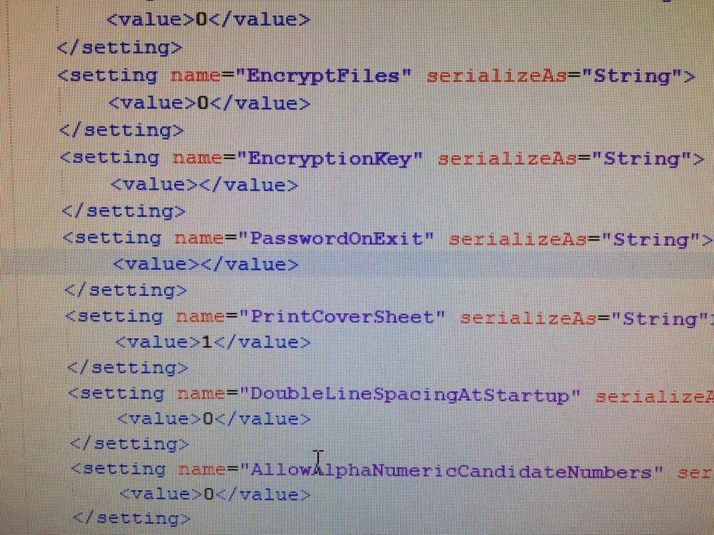

Hi,
Thanks for this, we've downloaded and installed. Just a couple of minor points I've seen. The password on exit feature - the default config file included with this version appears to have some spaces/carriage return and so it prompts for a password unless you remove this. Also, I noticed if you have the option set to allow long candidate numbers, the description next to the candidate number on the candidate information screen doesn't change to reflect the new character limit of 12 - still says 4.
Top job as always, thanks :-)
Hi,
The default config is blank and has no value specified (see screenshot)e78e1887-359b-4bb2-826a-fed9c67f207d.jpg
You are correct with the allow long candidate names description and I will change for next build.
Thanks! That's odd, I've looked at the default config in the zip file and mine too is also blank as per your screenshot. But it wasn't earlier. It had some spaces and a carriage return. Could it be the config file editor that added this somehow? As I ran it through that. All was fine once I removed the spaces.
Probably is the config editor, will take a look thanks
Hi,
This is now fixed and will be release later this week.
This fixed version will work for all config options that need to remain blank for whatever reason.

FIXED: Config File Editor would render empty config options with carriage returns and extra whitespace upon saving. So config options like ‘PasswordOnExit’ would fail regardless as you can’t type in a carriage return.
