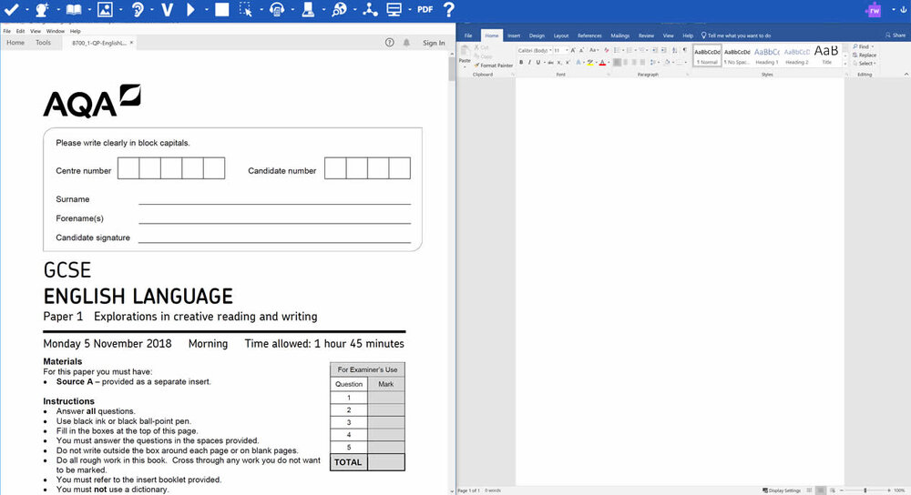

smarties11 Posted November 20, 2018 Posted November 20, 2018 @ass17 Hi - I was wondering if I could make a feature request please? We have recently purchased TextHelp Read&Write computer reader software, that students will be using in mock exams next week instead of a human reader. It seems to work alongside Exam WritePad quite well, however one issue is that the students, in their normal way of working, usually split their screen so that their source document is on the left hand side of the screen, and their written work is on the right hand side of the screen. So in an exam, they'd want the exam paper on the left, and Exam WritePad on the right - that way they can use Read&Write to read aloud their exam paper and their written answers. This isn't currently possible, because you can't resize the WritePad window; it's either full screen on minimized. Do you think this would be possible? We'd find it very useful here. We will have to use MS Word for our mocks next week instead of WritePad but I'd love it if we can use WritePad again in the summer series, with the split screen functionality. Thanks for all your efforts with WritePad; we love it here and have been using it for a couple of years now. I'm dreading moving back to Word next week!
ass17 Posted November 20, 2018 Author Posted November 20, 2018 @ass17 Hi - I was wondering if I could make a feature request please? We have recently purchased TextHelp Read&Write computer reader software, that students will be using in mock exams next week instead of a human reader. It seems to work alongside Exam WritePad quite well, however one issue is that the students, in their normal way of working, usually split their screen so that their source document is on the left hand side of the screen, and their written work is on the right hand side of the screen. So in an exam, they'd want the exam paper on the left, and Exam WritePad on the right - that way they can use Read&Write to read aloud their exam paper and their written answers. This isn't currently possible, because you can't resize the WritePad window; it's either full screen on minimized. Do you think this would be possible? We'd find it very useful here. We will have to use MS Word for our mocks next week instead of WritePad but I'd love it if we can use WritePad again in the summer series, with the split screen functionality. Thanks for all your efforts with WritePad; we love it here and have been using it for a couple of years now. I'm dreading moving back to Word next week! Thanks for the info, are you saying that EWP always opens full screen on the left (primary monitor) and you actually want to be able to move it to the right on the secondary monitor? Regads Andy
smarties11 Posted November 20, 2018 Posted November 20, 2018 Thanks for the info, are you saying that EWP always opens full screen on the left (primary monitor) and you actually want to be able to move it to the right on the secondary monitor? Regads Andy @ass17 Hi Andy, No, sorry. We only have one monitor on the exams computers. I want to be able to move EWP so that it occupies only either the left half of the screen, or the right half of the screen. In Win7 and Win10 you can do this with other apps by dragging the app to the far left or right edge of the screen. But we can't do this with EWP because it doesn't have a header bar at the top, so it's either full screen or minimised by using the button you added on the toolbar. Example attached using Word instead of EWP....
ass17 Posted November 20, 2018 Author Posted November 20, 2018 @ass17 Hi Andy, No, sorry. We only have one monitor on the exams computers. I want to be able to move EWP so that it occupies only either the left half of the screen, or the right half of the screen. In Win7 and Win10 you can do this with other apps by dragging the app to the far left or right edge of the screen. But we can't do this with EWP because it doesn't have a header bar at the top, so it's either full screen or minimised by using the button you added on the toolbar. Example attached using Word instead of EWP.... [ATTACH=CONFIG]51080[/ATTACH] Ah I see the snap to left/right screen feature. This is something I would have to play with simply because there is no scale ability/zoom of the actual page size like you can in word. Might take a few weeks to investigate but we have time :-)
smarties11 Posted November 20, 2018 Posted November 20, 2018 @ass17 Awesome, thank you very much! For us, the scaling wouldn't be an issue as our IT suite computers have 23" screens and run in 1920x1080, and we run EWP with the StartPageWidth setting at 1. But I can see what you mean. If working with the snap to left/right isn't possible, even the ability to manually resize the EWP window would help. Thanks!
mavhc Posted November 20, 2018 Posted November 20, 2018 @ass17 Hi - I was wondering if I could make a feature request please? We have recently purchased TextHelp Read&Write computer reader software, that students will be using in mock exams next week instead of a human reader. It seems to work alongside Exam WritePad quite well, however one issue is that the students, in their normal way of working, usually split their screen so that their source document is on the left hand side of the screen, and their written work is on the right hand side of the screen. So in an exam, they'd want the exam paper on the left, and Exam WritePad on the right - that way they can use Read&Write to read aloud their exam paper and their written answers. This isn't currently possible, because you can't resize the WritePad window; it's either full screen on minimized. Do you think this would be possible? We'd find it very useful here. We will have to use MS Word for our mocks next week instead of WritePad but I'd love it if we can use WritePad again in the summer series, with the split screen functionality. Thanks for all your efforts with WritePad; we love it here and have been using it for a couple of years now. I'm dreading moving back to Word next week! Can you get PDFs of actual exams on the day then, for computers to read out loud?
smarties11 Posted November 20, 2018 Posted November 20, 2018 Can you get PDFs of actual exams on the day then, for computers to read out loud? Yes, if you request them. Exam boards say they make them available 90 minutes prior to the exam, however in practice they're often not available until closer to 60 or 45 mins prior. Our exams office request PDFs and then use these for students who require them printed on a particular colour paper etc. This year we will be using Read&Write to read them aloud (through headphones) for those students who in the past had human readers. Worst case scenario if the exam boards don't provide the PDF in enough time, the exams staff can scan an original exam paper from the sealed bag and Read&Write has built in OCR functionality and can then read that. But obviously it is better to have an original. I just wish the exam boards would allow us to have the PDFs sooner. Schools with a high proportion of SEN students with access arrangements must really struggle!
