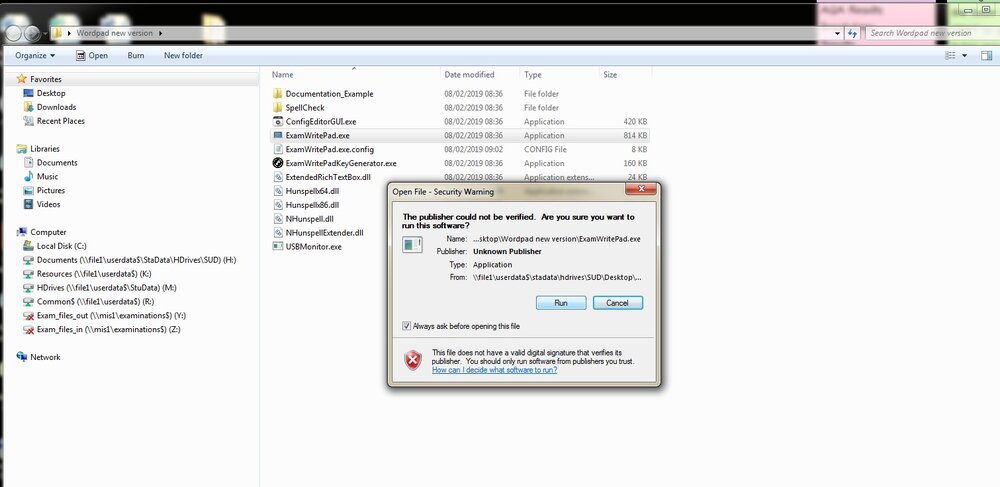

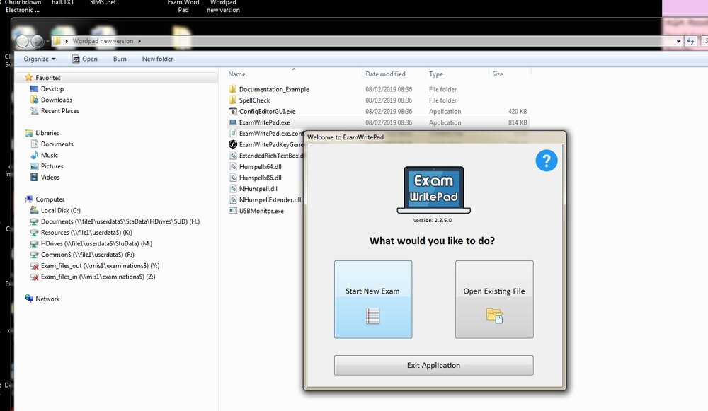

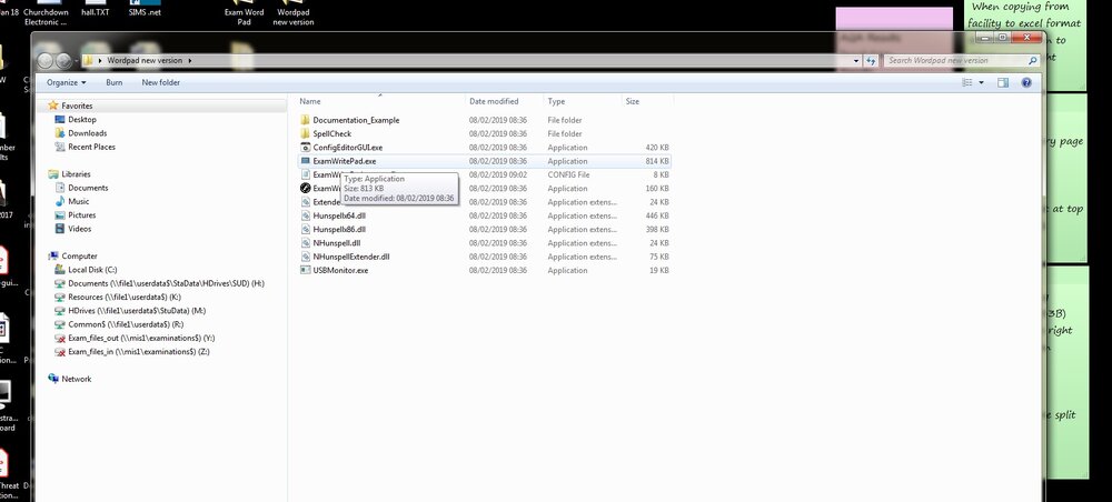

Your config file is fine for me and I ran it, Startup screen appeared, then clicked on start new, then up popped the candidate information window. Any chance you could send me a video/screen recording if the startup process?
