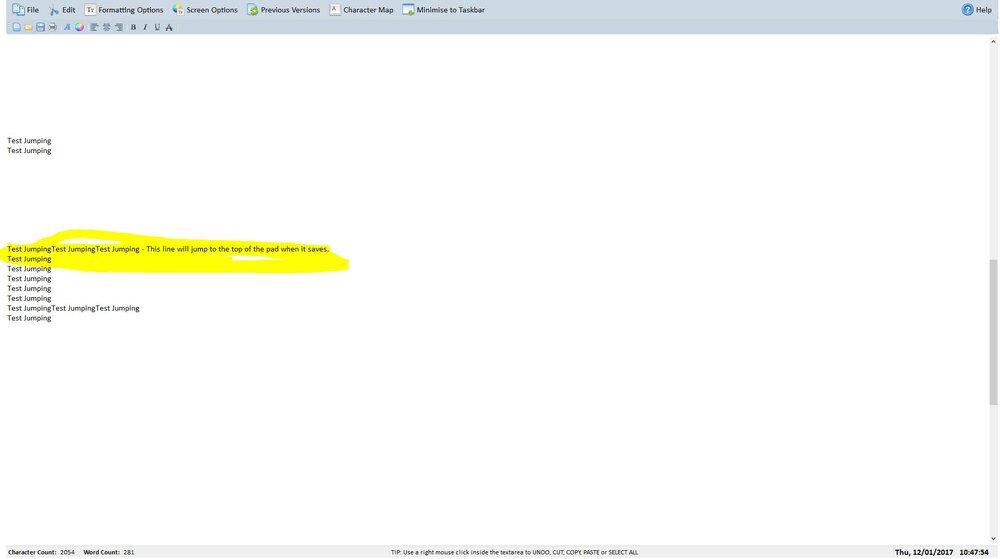

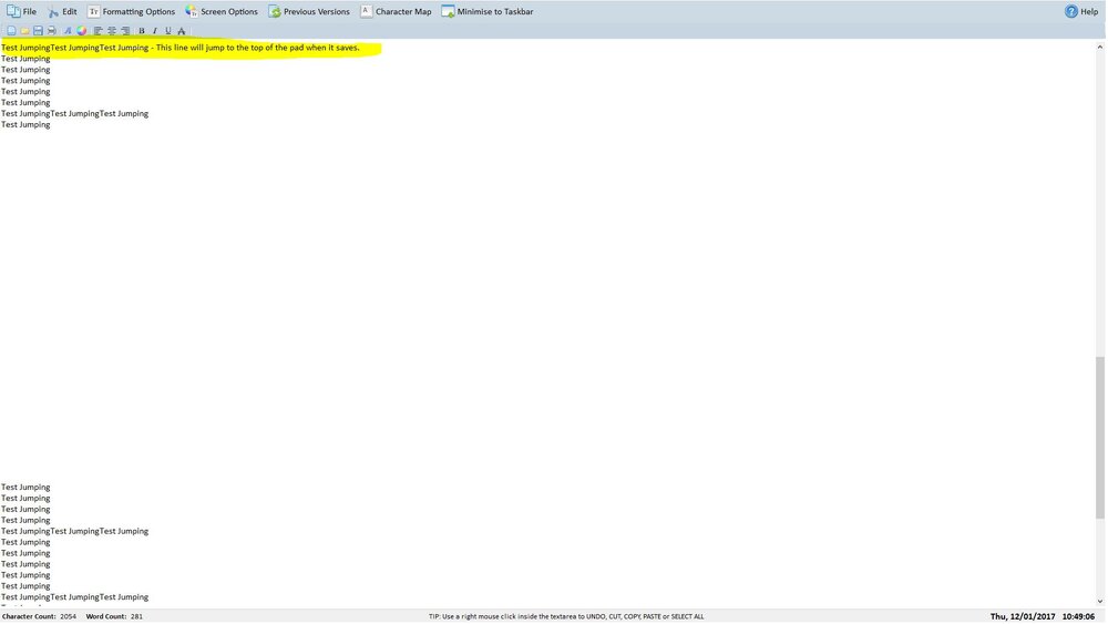

Thanks for this. I still have the issue of when the document manually saves or autosaves, the cursor is in the correct position but it will jump that line of text to the top of the pad. Not to the beginning but if there is a scroll wheel, it will jump to the top. I've added some photos to try and explain. Which ever line the cursor is on, that line will jump to the top. Not major issue but a student has brought it up.

Ok I see, I think I'll try to find a way to save without moving the cursor at all, need to see why it's moving in the first place.

With version 2.0.7.7 I cat get it to do what you describe. I created a 4 page document and while I was typing when manual saving and auto-saving it always stays and doesn't move. So if the cursor was at the bottom of the window, this is where it says and doesn't jump. Also nowhere in my code does it state to jump the writing window, so really cant do much at the moment, no-one else has reported this either, I'm scratching my head with this one sorry!!
