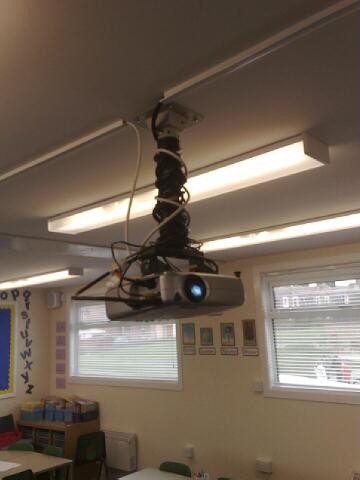

Friez Posted April 4, 2008 Posted April 4, 2008 Can you beat this? I think the only way to improve that is to use insane amounts of gaffer tape to attach the projector to the roof rather than bolting it on!
chrbb Posted April 4, 2008 Posted April 4, 2008 My cat came home late this week clutching a projector warrenty and wire cutters - now I know where he was! Is this a late April fools?
Paul_L Posted April 4, 2008 Author Posted April 4, 2008 Is this a late April fools? Sorry to say, but defiantly not I can take you and show you the classroom it's in!
elsiegee40 Posted April 4, 2008 Posted April 4, 2008 Is it just hanging from the cables? There's enough wire there to support the projector without a ceiling mount! I do think the installer needs more practice before getting GCSE macrame!

flashsnaps Posted April 4, 2008 Posted April 4, 2008 He must of done it for free surely? Shocking! Whats all the extra cabling about?

davyboi Posted April 4, 2008 Posted April 4, 2008 hes abviously used a cable thats waaaaaaay too big probably not realsing untill he arrived that it is a solid ceiling and not suspended, and had no where to hide the spare cable.
sharkster Posted April 4, 2008 Posted April 4, 2008 what was the company who installed that? jus so i know not to use em
russdev Posted April 4, 2008 Posted April 4, 2008 hes abviously used a cable thats waaaaaaay too big probably not realsing untill he arrived that it is a solid ceiling and not suspended, and had no where to hide the spare cable. and fact he didnt know how to rewrite it so that cuts some of excess cable off... wow that is a bad install.. Russell

webman Posted April 4, 2008 Posted April 4, 2008 Power cables can get very hot when coiled like that, very dangerous.

PEO Posted April 4, 2008 Posted April 4, 2008 got my electrician head on now. Thats not funny, its blooming dangerous. the heat generated will eventually cause a serious fire. If health and saftey see that, god knows what would be said.
Joedetic Posted April 4, 2008 Posted April 4, 2008 I thought it was the resistance that caused the heat?
localzuk Posted April 4, 2008 Posted April 4, 2008 That is pretty bad! We have a projector in one of our ICT suites that has a 10ft drop from the ceiling to the projector (tall rooms). When I turned it off a while back, I noticed it wobbled back and forth. It turned out that whoever had installed it had used bolts straight through the plasterboard ceiling! We had it fixed by having supports added within the ceiling which the mount was than attached to. We were so lucky it didn't fall on someone's head!! It would've killed them, easily.
torledo Posted April 4, 2008 Posted April 4, 2008 (edited) Can you beat this? One of our projector installs would look exactly like that if we didn't have a suspended ceiling to hide an insane amount of excess wire. How difficult is to estimate the length of preterminated cable you need ?.....but more to the point most of the school projector installers are of the crash bang wallop variety, they'd rather not mess around with the delicate art of soldering vga pins. That's why they go for the lindy 10m+ lengths. It's a shame because a proper install requires the installer to have that ability....run the correct length snip off a either end and then solder on. Even if they had gone for a more realistic length they would still have had some excess and they're no way to hide any excess in that picture. But soldering vga pins is a dark art. Requiring a pair of pliers with an elastic band on the end and preferably a magnifying glass for the oldies willing to give it a go. Plus alot of patience and a massive amount of practice. on a side note has anyone tried using those screw terminal three pin ends for when you're shortening power cables of electrical appliances (IEC-320 or kettle leads as some people mistakenly say). They are blooming terrible absolutely the worst design i hve ever come across. It's just ridiculously easy for all three cores to come out at any time. The number of times i've blown a fuse after doing one and then trying to test it out. Whoever designed them shot be shot.....trouble is i can't find any other design. Edited April 4, 2008 by torledo

PEO Posted April 4, 2008 Posted April 4, 2008 I thought it was the resistance that caused the heat? when cable is coiled, it inefect acts like a heating element, as the heat increases so does resistance. the cable over time will deteriate and can cause an electrical fire.
tech_guy Posted April 4, 2008 Posted April 4, 2008 when cable is coiled, it inefect acts like a heating element, as the heat increases so does resistance. the cable over time will deteriate and can cause an electrical fire. What if you do loose 'figure of eights' with the cables? Is that still a hazard?
SYNACK Posted April 4, 2008 Posted April 4, 2008 What if you do loose 'figure of eights' with the cables? Is that still a hazard? Any setup where the cable retraces its own path in the same direction multiple times will cause issues. This is because by coiling the wire then running a current through it it effectively turns into an inductor (electro-magnet). There are several issues with this, the first is that it acts as a resister while it is setting up the magnetic field, when the the field is established it has effectively a capacitance (energy stored in the magnetic field) which will discharge very quickly and at a high voltage when the power is disconnected (the power cables don't get to bad as its AC but the constant opposition of the current as it changes polarity by the existing field causes the heat issue). This puts you gear at risk of power surges and exposes it to extra EMI. If the figure eights were to constantly reverse direction ie one clockwise one counter clockwise some how it should be ok. The magnetic fields that cause the issue should cancel each other out.
Sylv3r Posted April 4, 2008 Posted April 4, 2008 Is this a professional install or something you have knocked up as a short term fix? I would have refused to sign the job off if anybody left anything like that here.
