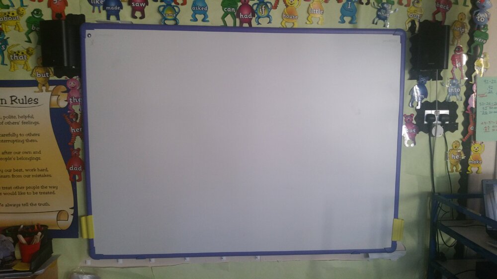

I have a promethean board, when I try to write in active inspire it is spiking. When I try to calibrate the board I have to put force on the +. The Firmware is V3.29 Build 5, Driver Version is V5.8.46.3. I am using windows 7 OS. I have installed the latest version on Active Inspaire v2.5.66477 still the same issue. Below is a picture of the board.

[ATTACH=CONFIG]35452[/ATTACH]

Hello Harry,
I experience this myself and found after trying everything that it is a known fault on Promethean boards, You have to contact them and to a warranty repair its to do with the membraine that gets drawn on apparently?
